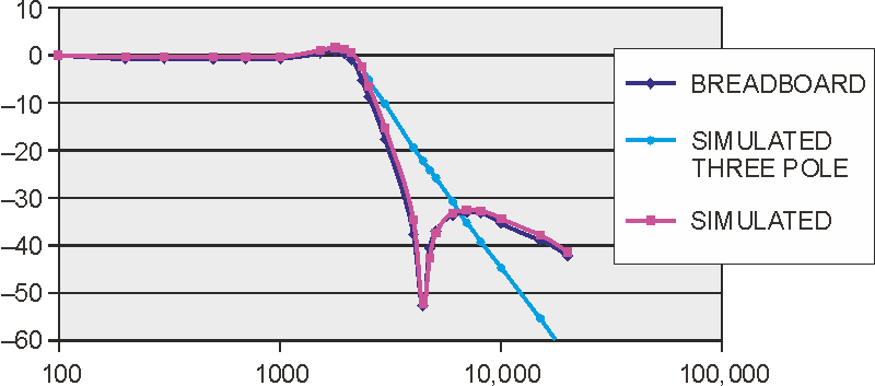

Figure 2. The improved cutoff rate of the filter results in a
quasi-elliptical response.
Select a value for R4 that's approximately one-third to one-fourth the value of R1, and then adjust R4 as needed to allow use of standard capacitor values. The graph in Figure 2 shows the improvement in the cutoff rate of the filter; the result is a quasi-elliptic response. A breadboard of the circuit in Figure 1b uses 5% parts. The measured results show good agreement with the Spice simulation. To take advantage of the faster roll-off, just scale the frequency and impedance to your application. The highpass dual of this circuit works as well as the lowpass version.
