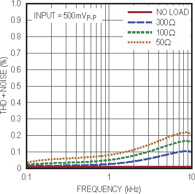

The LTC6263 provides four amplifiers in one small package. Data from a 2-amplifier LTC6262 driving what could be left or right is shown in Figures 2 and 3. Basic current consumption of the two amplifiers, with as much as 1 VP-P input but no load, is 500 μA.
Low Power Op Amp: Low Power Filter, Headphone Driver Revisited
Figure 2. LTC6262 Bridge Driver THD and Noise with
Different Loads vs Frequency.
The circuit consists of first, an inverting gain stage with closed loop gain = 1.5, and a subsequent inverting stage. The combination of inverting stages produces a single-ended input to differential output gain of 3.

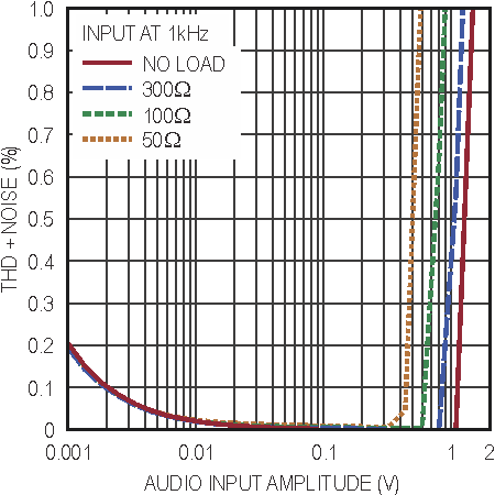

Figure 3. LTC6262 Bridge Driver THD and Noise with Different
Loads vs Amplitude at 1 kHz.
With 500 mVP-P input, the output is 1.5 VP-P, or 0.75 V max, or 0.53 VRMS. With 50 Ω, 500 mV input leads to approximately 5.6 mW delivered power. At 1 VP-P input, the circuit delivers 22.5 mW. Note that it helps that the LTC6261 output can swing close to rail-to-rail with load.
The first build of this circuit in the lab produced a significant tone at a few hundred Hz. It turned out that the positive input was not well grounded as an “AC ground” over all frequencies because the voltage was not strongly pegged. The need to peg the voltage arises when using a single supply rather than a dual supply. With a single supply, VM is not ground, but rather a mid-rail voltage created to enable inverting topologies to work properly. The resistor divider that creates VM has large resistance values (for example, two 470 k in series) to minimize additional supply current. A large capacitor ensures a strong ground at low frequencies. Indeed, the addition of a large capacitor (1 μF, which forms a pole with the 470 k resistors in parallel) eliminated the mysterious distortion tone.
Despite the low quiescent current, this driver delivers low distortion to a headphone load. At high enough amplitude, distortion increases dramatically as the op amp output clips. Clipping occurs sooner with more loading as the output transistors start to run out of current gain.
