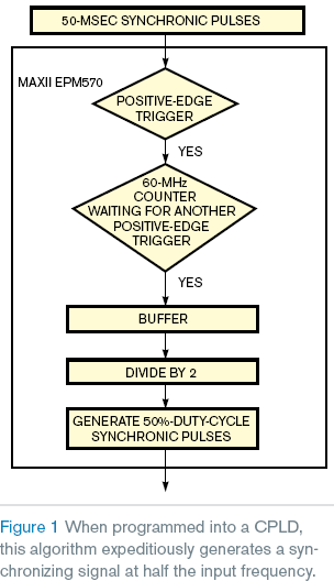

Figure 1 shows the half-duty-cycle generator’s algorithm. The CPLD first waits for the positive-edge trigger, then starts to count at a frequency of 60 MHz, and waits for the next positive-edge trigger. When the next positive edge comes, the synchronizing signal’s period counting is complete. The counting value then gets saved in a buffer and divided by 2 to yield the value for half-duty-cycle generation.
In tests, the half-duty-cycle generator in this Design Idea worked over a frequency range of 2 Hz to 450 kHz. You can use this design not only in a pulse generator, but also in any synchronizing signal in which the pulse is too narrow for other system triggering. The half-duty-cycle generator fits into a CPLD, such as an Altera EPM570 with a 60-MHz system clock and an MM74HCT244 buffer to output a TTL signal. Listing 1 contains the program for the CPLD.
