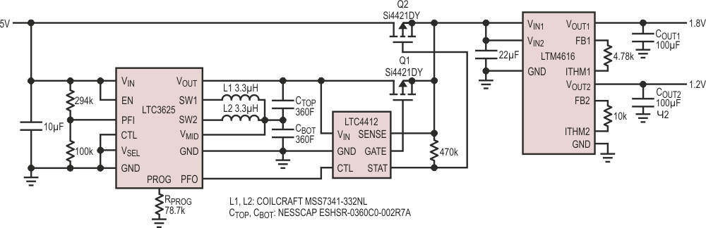

Redundant arrays of independent disks, or RAID, systems, by nature are designed to preserve data in the face of adverse circumstances. One example is power failure, thereby threatening data that is temporarily stored in volatile memory. To protect this data, many systems incorporate a battery-based power backup that supplies short-term power – enough watt-seconds for the RAID controller to write volatile data to nonvolatile memory. However, advances in flash memory performance such as DRAM density, lower power consumption and faster write time, in addition to technology improvements in supercapacitors such as lower ESR and higher capacitance per unit volume, have made it possible to replace the batteries in these systems with longer lasting, higher performance and “greener” supercapacitors. Figure 1 shows a supercapacitor-based power backup system using the LTC3625 supercapacitor charger, an automatic power crossover switch using the LTC4412 PowerPath™ controller and an LTM4616 dual output μModule® DC/DC converter.
Supercapacitor-Based Power Backup Prevents Data Loss in RAID Systems
Figure 1. Supercapacitor Energy Storage System for Data Backup.
The LTC3625 is a high efficiency supercapacitor charger ideal for small profile backup in RAID applications. It comes in a 3 mm × 4 mm × 0.75 mm 12-lead DFN package and requires few external components. It features a programmable average charge current up to 1 A, automatic cell voltage balancing of two series-connected supercapacitors and a low current state that draws less than 1 μA from the supercapacitors.

The resulting estimated values of RT(MAX) = 36 mΩ and RT = 40 mΩ are close enough for this stage of the design. VC(UV) is estimated at 3 V. CMIN is 128 F. Two 360 F capacitors provide an end-of-life capacitance of 126 F and ESR of 6.4 mΩ. The crossover switch consists of the LTC4412 and two P-channel MOSFETs. The RDS(ON), with a gate voltage of 2.5 V, is 10.75 mΩ (max). An RT of 26.15 mΩ is well within RT(MAX). The value for RPROG is estimated at 79.3k. The nearest standard 1% resistor is 78.7k. The data sheet suggests a 3.3 μH value for both the buck and boost inductors.
The LTC3625 contains a power-fail comparator, which is used to monitor the input power to enable the LTC4412. A voltage divider connected to the PFI pin sets the power fail trigger point (VPF) to 4.75 V.

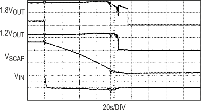

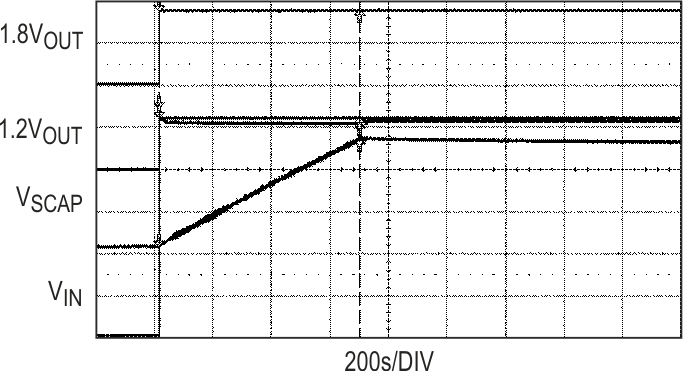

Figure 2 shows the actual backup time of the system with a 20 W load. The desired backup time is 45 seconds, whereas this system yields 76.6 seconds. The difference is due to a lower RT than estimated and an actual VUV of 2.44 V. Figure 3 shows the actual recharge time of 685 seconds compared to the 600 seconds used in the calculation, a difference due to the lower actual VUV.
