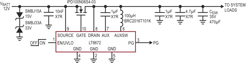

Figure 1 shows a complete protection solution.
Active Rectifier Controller with Ultrafast Transient Response and Low Power Dissipation
Figure 1. LT8672 Active Rectification/Reverse Protection Solution.

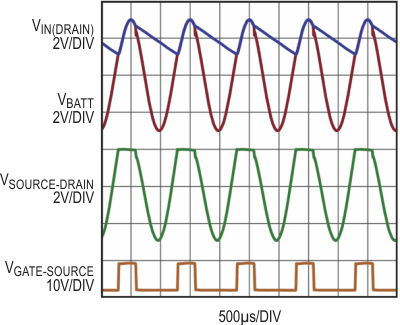

Fast Response for Input Ripple Rectification
Automotive standards – ISO 16750 or LV124 – specify that automotive electronic control units (ECUs) may face a supply with a superimposed AC ripple of up to 6VP-P at up to 30 kHz. The LT8672's gate driver that controls the external MOSFET is strong enough to handle ripple frequencies of up to 100 kHz, which minimizes reverse current. An example of such an AC ripple rectification is shown in Figure 2.
Figure 2. Rectification of Input Ripple.

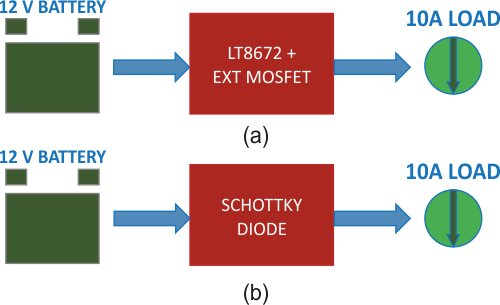

Figure 3. System Configuration (a) LT8672 Controlled
System (b) Schottky Diode System.
The performance of the LT8672 (using the IPD100N06S4-03 as external MOSFET) can be compared to a Schottky diode (CSHD10-45L) with the setup shown in Figure 3. Here, a 12 V power supply at the input emulates the automotive voltage supply, and the output is loaded with a constant current of 10 A. Thermal performance for both solutions at steady state is shown in Figure 4. Without cooling, the thermal performance of the LT8672 solution is far superior, reaching a peak temperature of only 36 °C, while the Schottky diode solution reaches a much higher 95.1 °C.

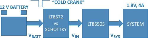

Automotive mission critical circuitry must be able to operate during cold crank conditions, when the car battery voltage can collapse to 3.2 V. With this in mind, many automotive grade electronics are designed to operate down to 3 V input. A Schottky’s variable forward voltage drop can present a problem during cold crank, where this drop produces a downstream voltage of 2.5 V to 3 V, too low for some systems to operate. In contrast, a LT8672 solution guarantees the required 3 V due to its regulated 20 mV voltage drop, allowing easier circuit design and improved system robustness.
Figure 5. System Configuration for Cold Crank Test.

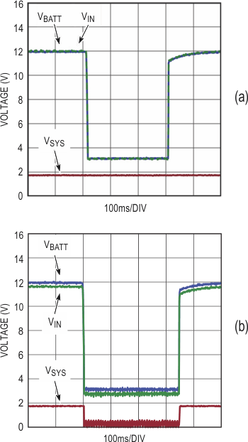

Figure 5 shows a comparative cold crank test setup using an LT8650S step-down converter as the downstream test system. The LT8650S output is set to 1.8 V at a constant load of 4 A, and its minimum input operating requirement is 3 V. The results are shown in Figure 6.
Figure 6. System Voltage Comparison Under “Cold Crank” (a)
LT8672 Controlled System (b) Schottky Diode System.
When VBATT drops to 3.2 V, the LT8672 controlled system (a) maintains VIN > 3 V, allowing the LT8650S to keep its output VSYS stable at 1.8 V, while in the Schottky diode system (b) the input voltage VIN of the LT8650S drops below its minimum operating voltage, preventing it from maintaining 1.8 V at its output VSYS.
