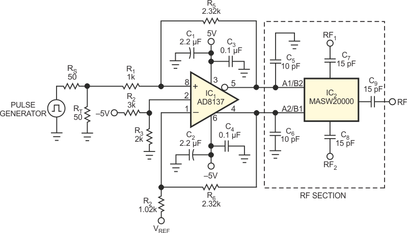

Designed as a high-speed driver for 12-bit ADCs, the AD8137 controls SPDT GaAs (gallium-arsenide) FET-MMIC (microwave-monolithic-IC) and PIN-diode RF switches and thus provides a low-cost and versatile alternative to conventional switch drivers. This circuit achieves typical switching speeds of approximately 7 to 11 nsec, including the propagation delays of the driver and RF load.
Differential driver doubles as versatile RF-switch driver
Figure 1. ADC driver IC1 converts TTL levels to differential-control signals for GaAs RF switch IC2.
The GaAsFET-driver circuit (Figure 1) converts a single-ended, 0 to 3.5 V TTL signal into a complementary, 0 to –4 V differential-output signal. The divider formed by the 50 Ω source impedance, RS, and the input termination, RT, imposes a 50% signal reduction. To compensate, the circuit amplifies its input by approximately 2.3 times to yield the proper output amplitude of 4 V p-p. The circuit also shifts the output level by –2 V to provide the proper GaAsFET bias. Equation 1 determines the output voltage:
  (1)
For a symmetrical output swing, gain-setting resistors R1 and R4 must present the same Thevenin-equivalent resistance. In Figure 1, R4 increases by 20 Ω over R1. This increase compensates for the fact that source resistor RS and termination resistor RT combine in parallel to introduce additional resistance of 25 Ω. Setting R4 to 1.02 kΩ (the closest standard value to 1.025 kΩ) ensures that the circuit will provide approximately equal gains at the differential outputs.

The AD8137's VOCM input (Pin 2) offers a convenient method of shifting the outputs' dc common-mode level. In Figure 1, R2 and R3 form a voltage divider, which sets the dc output level to –2 V. Connecting the AD8137's inverting input to a reference voltage of 1.75 V establishes the midpoint of the input signal and allows for proper switching of the AD8137's input stage.
