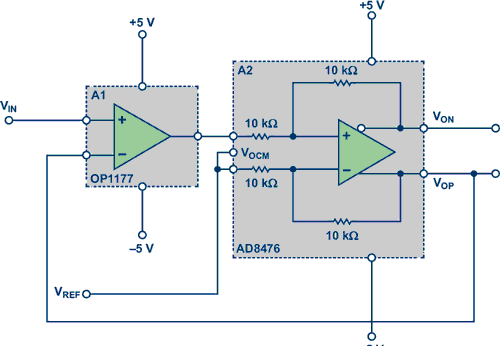

Differential signaling finds useful application in circuits where a large signal-to-noise ratio, high immunity to noise, and lower second harmonic distortion are desired, such as in driving high performance ADCs and high fidelity audio signal conditioning. A related previous article in Analog Dialogue, "Versatile, Low Power, Precision Single-Ended-to-Differential Converter,"1 offers a greatly improved single-ended-to-differential circuit that has very high input impedance, 2 nA maximum input bias current, 60 µV maximum offset (RTI), and 0.7 µV/°C maximum offset drift (Figure 1). The improved performance is achieved by cascading an OP1177 in the feedback loop with the AD8476 that has a differential gain of 1.
Versatile, Precision Single-Ended-to-Differential Signal Conversion Circuit with Adjustable Output Common Mode Boosts System Dynamic Range
Figure 1. Improved single-ended-to-differential converter.

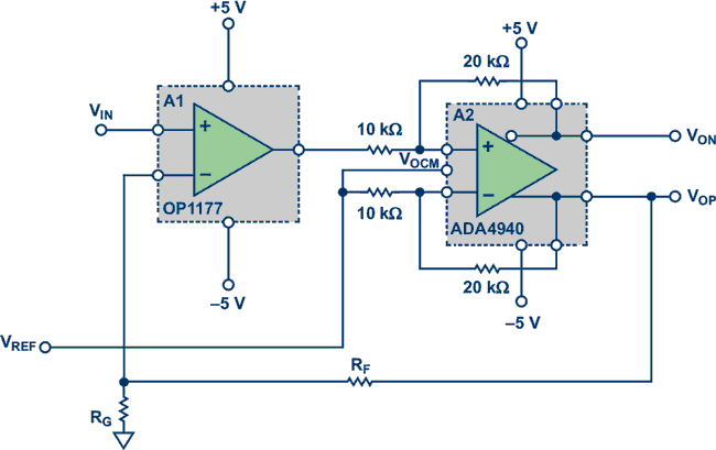

Configuring the differential amplifier inside the loop to a gain greater than 1 increases the output dynamic range of the circuit (Figure 2). The output is given by the following equation:
When RG is left open the circuit has an overall gain of 2. The output of A1, OP1177, is given by the following:
Notice that the VREF is always added to the output of the OP1177 limiting its output headroom. In most applications the VREF (the output common mode) is set at the center of the supplies for maximum output dynamic range. A differential amplifier inside the loop configured at a gain greater than 1, such as the ADA4940 in Figure 2 (gain of 2), reduces the output voltage of A1 by a factor of A2's differential gain and helps avoid saturating the output of A1. Because the OP1177 has a typical output swing of 4.1 V at ±5 V supplies, the differential output voltage swing of the circuit in Figure 2 is about ±8 V at VREF set at 0. Configuring A2 to a gain of 3 further improves the output dynamic range and achieves the maximum output swing of the circuit. Another amplifier, the ADA4950 with available gains of 1, 2, and 3, may also be suitable for A2.

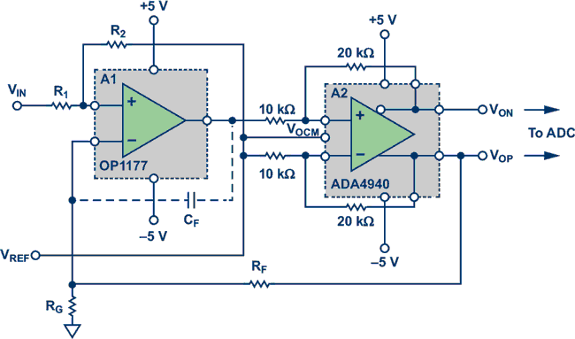

The circuit can be modified to make the output common mode adjustable and independent of the common mode of the input signal. This adds great flexibility and convenience for single- supply applications where the input is referred to ground and is needed to be converted to a differential signal with an elevated common mode for ADC interfacing.
This can be accomplished by adding two resistors at the input R1 and R2, where R2 is tied to VOCM. If desired, using a dual version of the input amplifier A1, the OP2177, allows for the second amplifier to be used as a buffer to the input for very low input bias current.
Figure 3a. Improved single-ended-to-differential converter with adjustable common mode.
In the circuit in Figure 1, the input is referred to VREF. Referring to the circuit in Figure 3a, the input is referred to ground taken directly and converted to differential output. The VOCM can now be adjusted to shift the common-mode output while the input remains referenced to ground. The VOCM can be tied to half of the reference or the midscale of the converter. The VOCM basically acts as another input along with VIN. The values of the resistors should be chosen such that
By superposition, when VIN is 0, the output is forced at the same value as VOCM. And since VOCM is the value that sets the output common mode, the differential output is zero. If R1 = RG and R2 = RF, the output voltages are given by:

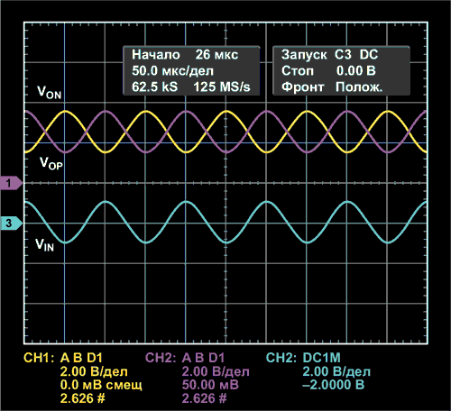

Figure 3b. Input and output plots, VOP in red, VON in yellow, and input in blue.
Common mode is at 0 V.
Figure 3c. Input and output plots, VOP in red, VON in yellow,
and input in blue. Common mode is at 2.5 V.
