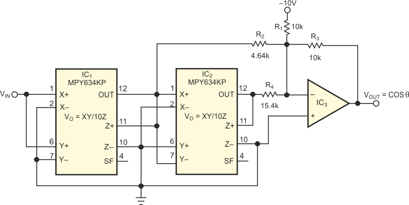

The circuit in Figure 1 converts a ±10 V analog voltage representing an angle between θMIN and θMAX and emits a voltage equal to 10·cosθ. This circuit can have an accuracy of better than 1% over ±120° or better than 0.2% over ±90°. These figures represent an order-of-magnitude improvement over a Taylor-series estimate for the same range and for the same number of multiplications. The Taylor-series definition for a cosine (with θ in radians) is:

Figure 1. By manipulating Taylor-series coefficients, you can obtain better accuracy when generating cosines.
Choosing the resistor values for the circuit is relatively simple. Set R1 and R2 equal to each other (for 10 V maximum input and a ≈ 1), and determine values for R2 and R4 by applying the following equations:
and

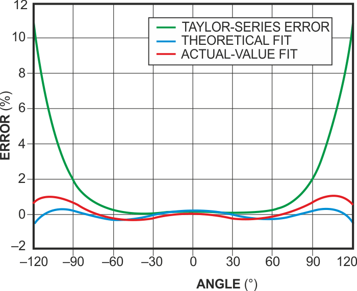

IC1 generates the square of VIN and negates it. This output sums through R2 into IC3. IC2 generates the fourth power of VIN and sums it into IC3 through R4. A –10 V reference across R1 creates the "a"-coefficient constant current into IC3. The output of IC3 is the sum of the three terms. Because IC1 is an inverting amplifier, the circuit configures the multipliers such that the output of IC1 is positive and the output of IC2 is negative. Choosing the proper 0.1% resistors can improve circuit accuracy to better than 1% for –120° to +120°. You should use a low-offset op amp for best results. Figure 2 shows the Taylor-series error, the theoretical fit, and the actual fit. For a fit in a 90° range, the values change slightly, and the errors across the range become significantly smaller. The constant "a" becomes 0.9996, b=0.4962, and c=0.0371. Then, R1=R3=10 kΩ, R2=8.16 kΩ, and R4=44.2 kΩ.
Figure 2. For angles greater than 90, the revised coefficients in Figure 1
yield significant accuracy improvements in calculating cosines.
You can use the same approach to efficiently calculate cosine and sine values in a DSP system more rapidly than using a look-up table.
