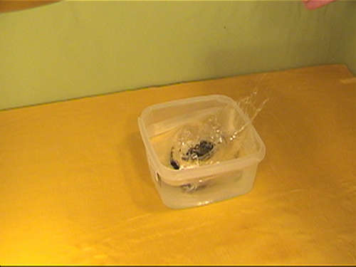

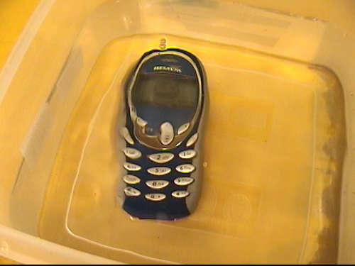

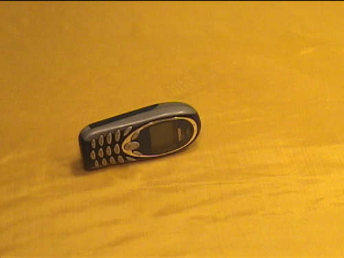

The most important thing you have to do is to get that phone out of the water as soon as possible don't just look dumb at it while it's drowning, act fast !
Remove it from the water [pic.1].[pic.2]
Even doe the phone was under water for only a few seconds the vibration function short circuited, resulting in the phone vibrating out of control to view this watch the video http://www.videojug.com/film/how-to-save-a-wet-cell-phone-2 or in [pic.3] .
So remember, removing it from the water as soon as possible makes the life/death difference !

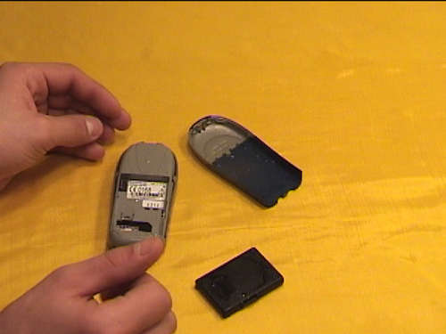

As fast as you can remove the battery from the phone, don't waste time switching it off first, just remove the battery as soon as possible.[pic.1]

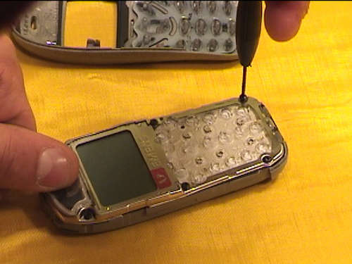

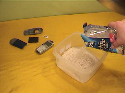

Using a small screwdriver take the phone apart as well as you can the more parts you remove the better but make sure you will manage to put everything back together once it's all dried out. [pic.2]. [pic.3]

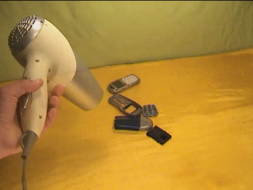

Do not use a hair dryer (even on a "cold" mode) to dry out the phone, as this may force moisture further into the small components, deep inside the phone. If moisture is driven deeper inside, corrosion and oxidation may result when minerals from liquids are deposited on the circuitry. Using a hairdryer might be a temporary fix, but this will eventually cause component failure inside the phone.
Now, you will need to take your disasembled phone, a bag of regular dry household rice, and an airtight container.

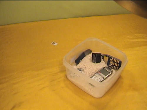

Take the rice [pic.1] , and pour it in the container half way full [pic.2] , take all the phone components and put them in with the rice [pic 3] , place the cap on the container and give it a good shake [pic.4]
Now let them dry for around 2 days, The rice will absorb any remaining moisture from within small components and prevent corrosion and oxidation.

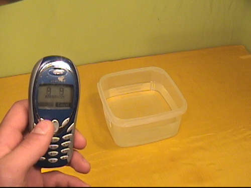

Then carefully put everything back together, part by part ... add the battery and try to start your phone.
Congrats you probably save your phone...
Even doe my phone short circuited it's vibration function during this experiment after it was subjected to the rice treatment it fully recovered and now it's working perfectly . [pic 1. & 2.]
