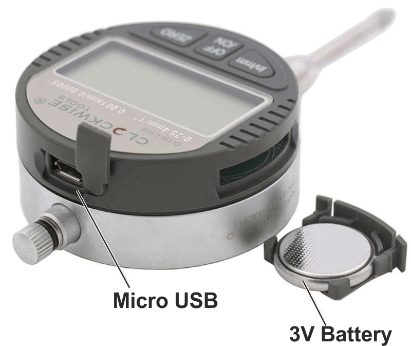

In this project, a digital DI oftypeClockwiseTools DITR0105 was used.
Electronic DI  ClockwiseTools DITR-0105
Figure 2. Electronic DI  ClockwiseTools DITR-0105
This device has an LCD for result-indication and a port for outputting measurement data in the form of a serial interface.
In the process of working with that DI , it turned out that the output port has three lines - the Ground( GRND), the Data (DT) and the Clock  line (CLK).
Signals shapes  of these lines are shown in Figures 3, 4, and 5.

When analyzing the situation, it became clear that to transfer this information to a PC, two problems had to be solved:
  1. The conversion / change of DI signal levels from non-standard levels (Low = 0 V, and High= 1.5 V) into TTL levels.
  2. TheDI data comesout in an unknown/nonstandard format and must be decoded / convertedinto a format compatible with a PC, for example RS232.
The first problem was solved by using a level shifter, which generates TTL level signals in order toapply them to digital uPinputs.
The second problem was  solved using the uP(ArduinoNano), which receives TTL signals to its inputs, processes them, and generates output data in the RS232 format (more precisely, the logical output format is RS232, but physically the signals come to the PC input over a standard USB port).
