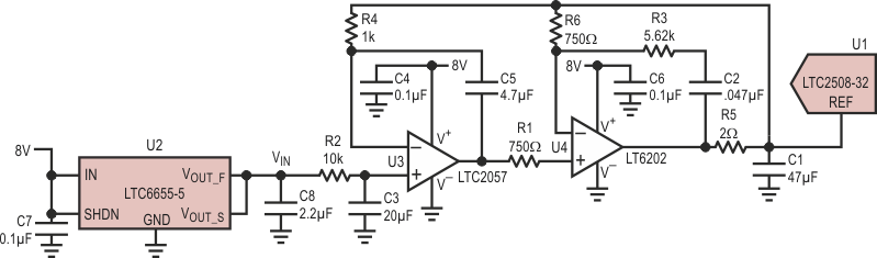

The circuit of Figure 1 filters the output of reference (U2) using R2 and C3 to form a 0.8 Hz filter. Capacitor C3 should be a film capacitor. Tantalum and electrolytic capacitors have high leakage that will produce an offset across R2. Ceramic capacitors can exhibit microphonic effects that result in increased noise at low frequencies. The filtered output is buffered by the high impedance input of U3. The 200 pA max IB of U3 results in a maximum voltage drop of only 2 μV across R2. This, combined with the LTC2057’s offset voltage, produces a maximum error of 6 μV which is relatively insignificant compared to the LTC6655-5’s maximum initial accuracy spec of 0.025% (1.25 mV). U3 and U4 form a composite amplifier that has the low offset, offset temperature coefficient and suppressed 1/f noise of the LTC2057 and the fast settling of the LT6202. The REF pin of U1 draws charge from C1 that varies with sample rate and output code. U4 must replenish this charge to keep the REF pin voltage fixed. R5 is used to isolate U4 from C1 to improve the settling at the REF pin. Physically larger ceramic capacitors with higher voltage and temperature ratings have lower voltage coefficients, providing a higher effective capacitance. For this reason C1 should be X7R with a 1210 size and 10 V rating.
| Figure 1. | Filtered LTC6655 Output Increases SNR of LTC2508-32 32-Bit ADC by 6 dB. | |

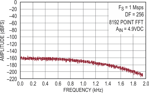

Chopper stabilized op amps such as the LTC2057 often exhibit tones at the chopping frequency and its odd harmonics. The LTC2057 utilizes circuitry to suppress these artifacts well below the offset voltage. This circuitry combined with the ADC’s own filter works to eliminate any visible tones from the op amp’s chopping frequency as shown in the noise floor plot of Figure 2. The plot of Figure 2 is an average of five data captures in an attempt to smooth out the noise floor to reveal even the smallest trace of any spurious tones.
| Figure 2. | Noise Floor of the LTC2508-32 near FS shows no spurious tones using the circuit of Figure 1 to drive the REF pin. |
