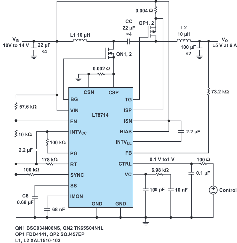

Figure 1 shows an electrical schematic of the LT8714 as a 2-quadrant power supply. The powertrain consists of NMOS QN1, 2, PMOS QP1, 2, inductors L1, L2, coupling capacitor CC, and input and output filters. Inductors L1 and L2 are two discreet, noncoupled inductors, an approach that can reduce the cost of the converter.
Two Terminal Bipolar Power Supply
Figure 1. An electrical schematic of a power supply based on the LT8714 operating in two quadrants VIN = 12 V,
VO ±5 V at 6 A.

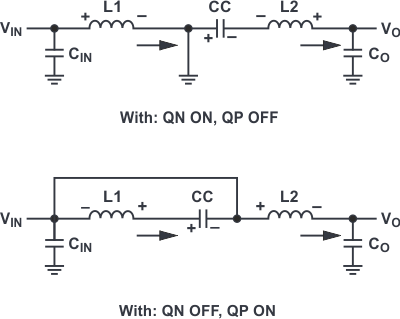

Proper selection of active and passive components requires understanding the voltage stresses and current levels present in each quadrant. For this purpose, the functional topologies for the positive output are shown in Figure 2.
The topology of a 2-quadrant operation with a positive output.
Figure 2. The topology of a 2-quadrant operation with a positive output.
When the volt-second balance is in a steady state, the duty cycle can be derived from the expression:
To verify the design, demonstration circuit DC2240A was reworked to match the schematic shown in Figure 1. The input voltage is a nominal 12 V, with output voltages of ±5 V at a maximum current of 6 A for both.

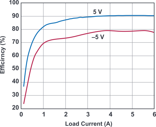

The measured efficiency for the design is shown in Figure 3. The positive output exceeds that of the negative output, which matches the results of theoretical calculations. The voltage stress and current on the components are much higher in the negative output configuration, increasing losses, and decreasing efficiency.
Converter efficiency curves with VIN 12 V, VO +5 V and -5 V, and a maximum IO of 6 A.
Figure 3. Converter efficiency curves with VIN 12 V, VO +5 V and –5 V,

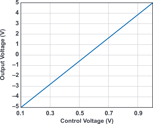

Figure 4 illustrates the excellent linearity of the output voltage vs. control voltage VCTRL. For this configuration, the circuit was loaded by a 1 Ω resistor, and the control voltage was varied from 0.1 V to 1 V.
A graph of the output voltage, VO, as a function of control voltage, VCTRL. As VCTRL changes from 0.1 V to 1 V, the VO changes from -5 V to +5 V.
Figure 4. A graph of the output voltage, VO, as a function of control voltage,
VCTRL. As VCTRL changes from 0.1 V to 1 V, the VO changes from –5 V
to +5 V.
