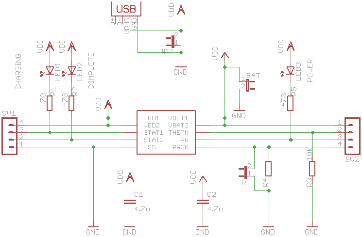

The schematic
LiPoly charging with MCP73833
The schematic is mostly a copy of the reference design. It has three LEDs, one for power good, one for charging and one for charging complete. All pins of the chip itself are also available on two header rows. The idea was to enable easy integration on a breadboard. Actually I misplaced the rows, so they don’t fit (#fail).
The resistor R4 is used to control the charge current. I used a socket for that, so I am able to adapt the current for different batteries. The 10k resistor results in a charge current of 100 mA.

The next version should include a jack for a wall adapter. The two header pins are not really useful to connect to a power supply. And of course the two rows of header pins should be aligned correctly to fit on a breadboard.
