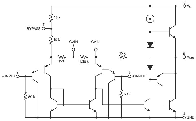

This LM386 schematic is taken from a Texas Instruments datasheet.
Figure 1. This LM386 schematic is taken from a Texas Instruments datasheet.
A close look at the LM386’s internal schematic shown in Figure 1 reveals that its voltage gain is determined by the ratio of its internal feedback resistors and the value of an optional (external) bypass resistor. If no bypass resistor is added, the device’s single input voltage gain is equal to
When used in differential mode (input to pins 2 and 3) its gain would be twice this value.
When a 10 μF capacitor is placed across pins 1-8, it bypasses the 1350 Ohm feedback resistor, causing the single input gain to change to 15,000/150=100. Moving the bypass capacitor between pin 1 and ground effectively bypasses the negative feedback resistors that determine the AC audio entirely. This results in an extremely high undetermined audio gain of 15,000/?, but it may be defined by adding a small resistor in series with the 10 μF bypass capacitor. A resistor with a value of 10 Ohms would give a gain of 15,000/10=1,500. In this configuration, the maximum voltage gain that may be achieved is in excess of 70 dB.

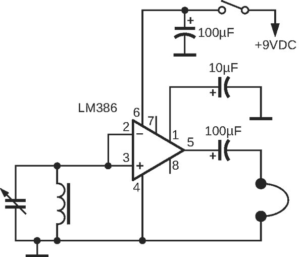

A simple TRF receiver
The LM386’s potential as a radio receiver was discovered a number of years ago while investigating anomalous behavior in a receiver that used one of these devices. During the troubleshooting, it became apparent that the LM386 was acting as a high gain RF envelope detector, which could be used as an AM receiver by simply connecting a tuned circuit to its input. It turned out that it was possible to create a simple tuned radio frequency (TRF) receiver by implementing the two features of the LM386 mentioned earlier and using a tuned standard MW ferrite rod inductor on the input. While not extremely sensitive, it is capable of receiving a few local stations without an external antenna when used in an urban environment. The circuit for this receiver is shown in Figure 2.
The LM386 can be used as a tuned radio frequency receiver.
Figure 2. The LM386 can be used as a tuned radio frequency receiver.

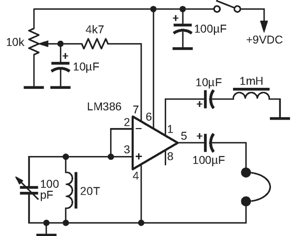

A regenerative medium-wave receiver

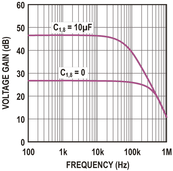

The datasheets for the LM386 indicate that its gain is greater than unity (10 dB) at frequencies exceeding 1 MHz (Figure 3). For this reason the LM386 is able to oscillate in the medium wave AM band (540 to 1600 kHz), making it possible to use it as a medium wave AM regenerative receiver. This significantly improves the sensitivity and selectivity of the TRF version. The result is shown in Figure 4.
This voltage vs frequency graph is taken from a Texas Instruments datasheet.
Figure 3. This voltage vs frequency graph is taken from a Texas
If the regeneration control is removed, the circuit becomes a Colpitts oscillator. The two required Colpitts feedback capacitors across the tank are the intrinsic input capacitance on pin 3 of the LM386 in series with the 220 pF capacitor to ground from pin 1. The audio gain is maximized by placing a choke in series with a 10 μF capacitor to ground. It may have a value from 1 to 10 mH. Higher value chokes will have some internal resistance, which will slightly reduce maximum audio gain. If using a smaller value choke and the audio gain is excessive, a small value resistor (10 to 100 Ohms) may be placed in series with the choke. The choke combined in series with the 10 μF capacitor bypass the internal feedback resistors that determine the amplifier’s gain for audio frequencies, but present a high impedance to RF frequencies so that the circuit might be used as a Colpitts RF oscillator. To control the gain so that the oscillator regeneration may be varied to enable its use as a regenerative receiver, a 10K variable resistor varies the voltage on pin 7, which decreases the current drawn by the oscillating transistor on non-inverting pin 3, which, in turn, reduces the oscillator gain.
This schematic shows how to use the LM386 as a medium wave regenerative receiver.
Figure 4. This schematic shows how to use the LM386 as a medium
