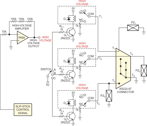

This Design Idea offers a practical approach to reducing high-voltage-induced noise. The floating input of a scanning electron microscope has high impedance, and it acts as an antenna, picking up noise signals. The microscope’s actuators need a high-voltage signal to drive their piezoelectric slip-stick stack motors. The motion mechanism requires a ramping waveform spanning to 800 V p-p. The mechanism requires multiple channels because there are three degrees of tip motion. Some microscopes incorporate optical-path-adjustment microsliders for atomic-force microscopy; those scopes need even more channels.

Traditionally, each channel needs a high-voltage amplifier. So, two degrees of tip motion need two high-voltage amplifiers, three degrees need three amplifiers, and so on. High-voltage amplifiers are expensive and need considerable space on the PCB (printed-circuit board), however. Therefore, controlling multiple degrees of tip motion using only one high-voltage amplifier that switches among multiple channels saves cost and space. The pins of high-voltage connectors have enough space between them to avoid disturbing adjacent signals. But high-voltage connectors are expensive and too large to easily arrange. So, the best choice is to use a commercial RS‑232-standard, nine-pin/25-pin connector (Figure 2). The pins of most commercial RS‑232 connectors are close enough together to easily pick up induced high-voltage signals. You can solve this problem by connecting a low impedance to the floating pins of the RS‑232 connector.
This simple circuit connects unenergized inputs to ground through a resistor.
Figure 2. This simple circuit connects unenergized inputs to ground through a resistor.
In this circuit, three piezoelectric motors, PZ1, PZ2, and PZ3, connect to the T1, T5, and T9 pins of the RS‑232‑9T connector. The circuit has three relays that switch the high-voltage input to the piezoelectric motors. The normally open node of the relays connects to the high-voltage-amplifier output. The normally closed nodes of the relays connect to three 1‑kΩ resistors to bypass high-voltage-induced noise to ground.
