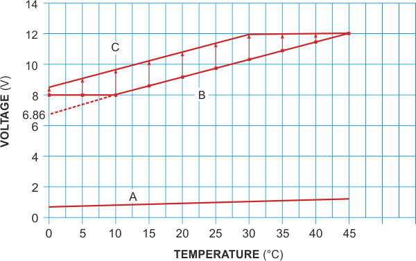

As an alternative, consider a low-cost, self-contained analog circuit for fan-speed control (Figure 1). You can easily adjust the circuit for any desired linear relationship between the fan voltage and temperature (Figure 2, curves B and C). We plotted measured data points against the desired voltage in Figure 2.
These curves illustrate voltage output versus temperature for the circuit in Figure 1.
Figure 2. These curves illustrate voltage output versus temperature for the circuit in Figure 1.
Curve A in Figure 2 represents the output of a MAX6605 analog temperature sensor versus temperature in degrees Celsius:
VSENSOR = 0.0119 V/°C + 0.744 V.
Curve B relates the fan voltage to temperature and combines a minimum “floor” voltage of 8 V with a sloping line:
VFAN = 0.114 V/°C × T + 6.86 V,
where T is the system temperature.
The floor voltage ensures fan rotation at low temperatures. Above 10 °C, the voltage increases with a slope of 0.114 V/°C until it reaches full value at 45 °C. Simply amplifying the MAX6605's output does not provide the 8 V floor voltage. Moreover, the gain

Thus, choosing R6 = 100 kΩ lets you calculate R5 = 169 kΩ. In some cases, the required offset gain is greater than the required slope gain, so you must increase the temperature sensor's natural offset. For a desired temperature, Curve C, expressed as
VFAN = 0.114 V/°C × T + 8.5 V,
the gain (slope) of AV = 9.58 is the same as for Curve B, but the required offset gain is (8.5/0.744) = 11.42 is greater. You therefore use the “To increase the offset” version of the circuit in Figure 1. The following equation applies in such cases:
