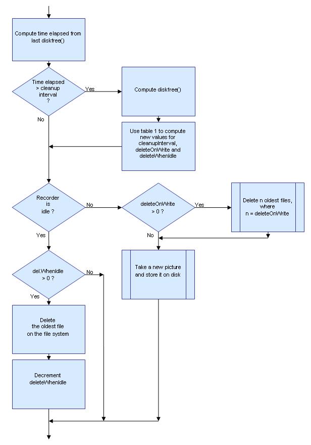

Filled to capacity
Keeping the disc filled to capacity, but not overfull, was a challenging problem.
In theory you can get disk occupation calling diskFree(), find the oldest file in the disk and delete it. In practice it turns out that both operations are time-consuming, so you must avoid them as much as possible. To complicate matters, file size isn’t constant. It depends on the scene and how it gets compressed by the JPEG algorithm. It depends also on the time of acquisition, because storing a picture file may require creating new directories (hence more disk space) each time the year, month, day, or hour change. And users are free to select a different resolution or recording mode at any time, changing the space required to accommodate new files.
I developed an heuristics based on common-sense rules:
  • When the disk is only partially full, it is sufficient to check disk occupation only every now and then, and all files can be conserved without problems.
  • As disk occupation increases, the amount of space left need to be checked more frequently, and it’s wise to start deleting some files. As deleting files burns precious machine cycles, it’s preferable to do it when the camera is idle, i.e. recording isn’t triggered.
  • Should disk occupation reach its limits, disk occupation checks must be performed frequently. Deletion of oldest files must be performed anyway, even if the processor needs resources for recording, because of the risk of getting out of disk space.
Based on the assumptions above, I wrote an algorithm that computes the value of two variables, deleteOnWrite and deleteWhenIdle, storing the number of files to delete according to the recorder’s state. (see diskCleanup(), file “archive.bas”). The algorithm computes also the interval between checks, cleanupInterval, using the rules outlined above and the following table:

Careful section of the value for deleteWhenIdle and cleanupInterval improves recorder’s performance in all but continuous recording modes, because all erasing is performed when there is nothing else to do. If you feel 1000 pictures is a large number, consider it represent a negligible percentage of full disk capacity. It takes time to get accustomed to the Gigabyte Age!
The flow chart in Figure should shed some light on how the heuristics works. Experimentation in my house as PIR-triggered recorder resulted in all file erases performed during idle, calling diskFree()at most every 30 minutes.
