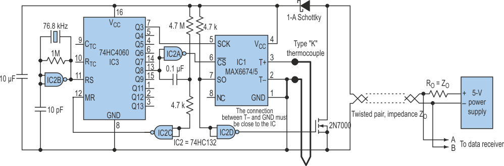

The usual options for minimizing noise include moving the controlling circuitry nearer the sensing point (since EMI is proportional to the wires' length), adding a remote board with local intelligence near the sensing point, or introducing complex signal filtering and cable shielding. A better solution is to digitize the thermocouple output near the sensing-point (Fig. 1). This is especially useful if the supervising microcontroller is distant from the sensing point.
Powered by a supply voltage at the far end of a 3000-ft cable, this circuit minimizes the effects of EMI by digitizing the thermocouple's signal near its sensing point.
Figure 1. Powered by a supply voltage at the far end of a 3000-ft cable, this circuit minimizes the effects of EMI
by digitizing the thermocouple’s signal near its sensing point.
In this example, the signal-processing circuitry consists of a low-level dc amplifier, a temperature sensor, a cold-junction compensation circuit, an analog-to-digital converter (ADC) with internal reference, an open-thermocouple detector and alarm indicator, and a digital-output interface. All of these functions are now integrated in small ICs, such as the MAX6674 and MAX6675. Their serial output is a digital representation of temperature at the thermocouple's sensing point.
Circuitry internal to the MAX6674/6675 thermocouple-to-digital converters is scaled for use with Chromel-Alumel (type K) thermocouples. The MAX6674 has a range of 0 °C to 128 °C with a resolution of 0.125 °C, while the MAX6675 has a range of 0 °C to 1024 °C with a resolution of 0.25 °C. Both ICs contain an SPI-compatible interface that works under the supervision of a microcontroller or similar local intelligence.
IC1's SPI is driven by a local pulse-sequence generator (IC2 and IC3), which forces IC1 to generate a train of asynchronous serial characters at 4800 bauds: one start bit, 11 data bits (13 for the MAX6675), and one stop bit. The 11 (or 13) data bits include 10 (or 12) straight-binary data bits for temperature (most-significant bit first) and one bit to warn of an open thermocouple.
The crystal-stabilized oscillator guarantees baud-rate accuracy for the data. The thermocouple's sensing tip must be electrically insulated for the circuit to operate correctly. You must also ensure that IC1 remains within its operating temperature range of –20 °C to 85 °C at all times.

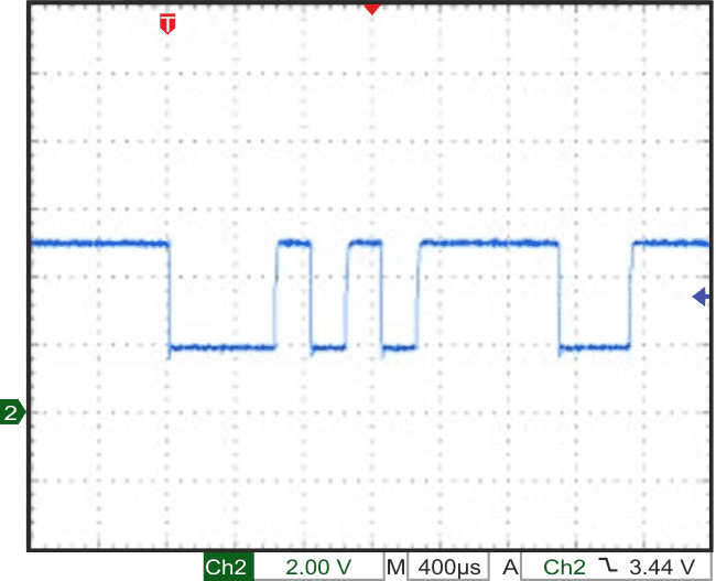

This serial data word (received at data-receiver terminals A-B
Figure 2. This serial data word (received at data-receiver terminals A-B
in Figure 1) represents a temperature of 21.875ºC, sensed by
the thermocouple at the other end of the cable.
The circuit connects to a distant power supply and data receiver via twisted-pair cable, which routes power to the circuit and brings digital data back to the data receiver. A temperature measurement consists of a single conversion by IC1's internal 10-bit ADC and is presented to the cable as a serial data word. Figure 2 shows an example of temperature data transmitted over a twisted-pair cable that's 3000 ft long. The data indicates a thermocouple in good working order, sensing a temperature of 21.875 °C.
