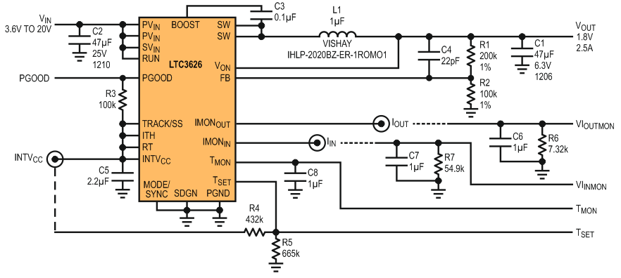

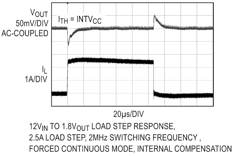

The LTC3626 synchronous buck regulator with current and temperature monitoring is the first of Linear’s SWITCHER+™ line of monolithic regulators. It is a high efficiency, monolithic synchronous step-down switching regulator capable of delivering a maximum output current of 2.5 A from an input voltage ranging from 3.6 V to 20 V (circuit shown in Figure 1). The LTC3626 employs a unique controlled on-time/constant-frequency, current-mode architecture, making it ideal for low duty cycle applications and high frequency operation, while yielding fast response to load transients (see Figure 2). It also features mode setting, tracking and synchronization capabilities. The LTC3626’s 3 mm × 4 mm package has such low thermal impedance that it can operate without an external heat sink even while delivering maximum power to the load.
20 V, 2.5 A Monolithic Synchronous Buck SWITCHER+ with Input Current, Output Current and Temperature Sensing/ Limiting Capabilities
Figure 1. 20 V Maximum Input, 2.5 A, 2 MHz Buck Regulator with Current
and Temperature Monitoring.
Beyond its impressive regulator capabilities, the LTC3626’s current and temperature monitoring functions stand out. They offer both monitoring and control capabilities with minimal additional components.

Figure 2. Load Step Response for Figure 1 Circuit.

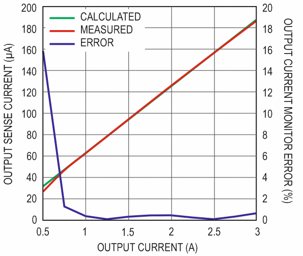

Output/Input Current Sensing
The LTC3626 senses the output current through the synchronous switch during the switch’s on-time and generates a proportional current (scaled to 1/16000) at the IMONOUT pin. Figure 3 shows the accuracy of the IMONOUT output by comparing the measured output of the IMONOUT pin with calculated values. Error remains less than 1% over most of the output current range.
Figure 3. Output Current vs Output Current Monitor

Both current signals are connected to internal voltage amplifiers, referenced to 1.2 V, that can shut down the part when tripped. So the input and output current limits are set by simply connecting a resistor to the IMONIN or IMONOUT pins, respectively, as shown in Figure 1. The relationship between the current limit and the resistor is:
For example, a 10 k resistor sets a current limit of approximately 2 A.
This simple scheme allows both monitoring and active control of the input and output current limits – the latter can be implemented via external control circuitry, such as a DAC with a few passive components.
