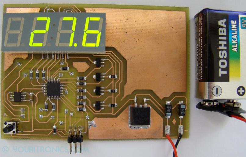

The easiest way to get the temperature out of the TMP275 seemed to be I2C. So I started by designing a board which has all the components needed: the sensor, an atmega8 brain, and some other components needed for the display and for powering the board. The display is a 4 digit 7 segment display from Kingbright product code CA56-12GWA. As for the display part of the board, I used PNP transistors on the common anodes and resistors on the segments to limit the current draw on the atmega’s pins. The transistors are not current limited so the display will alaways light-up the same no matter how many segments are turned on.
TMP275 digital sensor thermometer
For the supply part of the board, I choose to make it portable and power it from a 9V battery, so I needed to use a voltage regulator. The choice was the good old 7805 because it’s cheap and easy to find.
I2C is a pretty common protocol so various libraries can be found on the web. I chose Peter Fleury’s I2C library because it was very well documented. The only external components needed by the TMP275 are a bypass capacitor between VCC and GND and two pull-up resistors required on SDA and SCL lines.
All the I2C stuff is handled by the library, so I only had to write a couple of lines of code to get the temperature out of the sensor:

After reading the temperature from the sensor I had to display it on the 4 digit display. For that I had to write a display macro, which figures out the numbers and how to display them, basically I used software multiplexing. I even tested it on negative temperatures by placing the sensor in my fridge . The readout was correct because I checked with another thermometer.
