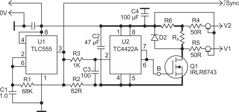

The circuit shown in Figure 1 provides a solution to the problem by applying a low duty cycle pulse to the unknown resistor and a reference resistor of a known value. A ratiometric technique is used to compare the response of the two components and determine the value of the resistor under test.
The circuit shown enables accurate measurement of very low resistance values by applying a low duty cycle pulse to the unknown resistor and a reference resistor of a known value.
Figure 1. The circuit shown enables accurate measurement of very low resistance values by applying
The measurements needed to calculate accurate resistance values can be obtained from the outputs V1 & V2 using an ordinary oscilloscope or, instead, a pulse peak voltmeter, which can provide higher precision.
The circuit uses the venerable 555 timer, running in an astable mode to produce pulses that are used to charge and discharge a low-inductance capacitor C2. During the discharge cycle, the current is passed through a precision standard resistor (R6) and the resistance under measurement (RX). The value of the resistance can be calculated from the ratio of the corresponding voltages:

The pulse Sync (U1, pin 3) facilitates the earlier synchronization of the scope; the delay between the Sync and the output pulse may allow the scope to catch the front of the pulse, since some scopes may have no delay line in their Y channel, making very steep fronts un-displayable. This delay is determined by the time constant R3•C3. The value of C3 may be in the range 20 – 500 pF (or even more), depending on the time base used and the scope itself.
The MOSFET driver U2 (TC4422A) is used to ensure high gate charging current for Q1 and fast switch-on time, which are essential for accurate measurements.
The MOSFET (Q1) has very low RDSOn (sub-3 Ω), to insure a clean, high-amplitude pulse. Fast diode D2 limits an overvoltage of Q1. Note: high currents occurring in this part of the circuit require special attention to both component selection and PCB layout. See the Component Selection Notes and Design Notes sections below for details.

The PCB traces around R6 and C4 must be kept short and laid out in order to minimize the parasitic reactances, which can lead to local resonances stimulated by the current pulses. If the circuit layout does not comply with this requirement, the absolute maximum voltage rating of MOSFET Q1 can be easily exceeded. For example, for a capacitive load of 6 nF (gate capacitance) the output rise/fall times of the driver TC4422A can be less than 25 ns; this fact, together with a large current (~100 A) through the inductances can produce voltages that would damage nearly any MOSFET.
Refer to the schematic to see the traces highlighted in bold – these traces must be wide enough to carry the high currents and be kept as short as possible to minimize parasitic inductance. This is especially critical for the trace connecting the gate to the driver (U2, pin 6 to base of Q1), which should be kept to less than one inch. A ferrite bead on this trace (B) can help suppress the unwanted oscillations.
For the same reason, the connections of the both resistors RX and R6 should be as close to the same length as possible. They should also be as short as possible to minimize inductances and voltage drops.
All external connections to the circuit should be designed using basic high-frequency practices. For example, using 50-Ω coax cables with good impedance matching on both ends is a must.
