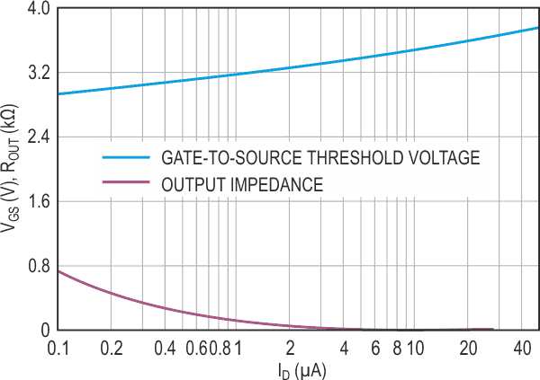

The MOSFET is self-biased by connecting its drain to its source. The difference between the input voltage, VIN, and the gate-to-source threshold voltage, VGS, sets the current. The IRF521 in this example has a threshold voltage of 2 to 4 V at 250 µA. The upper curve of Figure 2 shows that the IRF521 achieves a gate-to-source voltage of 3 V at a current of about 200 µA. MOSFETs can vary from device to device, but the typical MOSFET has a threshold at approximately the mean between the maximum and the minimum limits.
The lower curve in Figure 2 is the output impedance, which you obtain from the upper curve by differentiating the upper curve. Although the output impedance, ROUT, is near 800 Ω at a current of 100 µA, it rapidly drops to less than 6 Ω at 50 mA. Because you operate the MOSFET at or near threshold, its on-resistance spec doesn't apply, and the output impedance of this circuit is far higher than you would expect from the on-resistance. However, in general, the lower the on-resistance, the lower the output impedance at a specific current near threshold.
A plot of key parameters - gate-to-source voltage and output impedance - versus drain current shows smoothness of variation over two and one-half decades.
Figure 2. A plot of key parameters – gate-to-source voltage and output impedance
–versus drain current shows smoothness of variation over two and one-
half decades.
