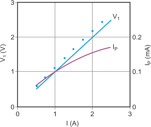

Figure 2 shows a circuit that needs no auxiliary transistor. The output stage of the op amp, in a sense, replaces the transistor. The current through RC is the same as that in Figure 1. Now, this current flows through the negative-supply pin of the op amp and serves as the current source for R1 as before. The circuit uses a low-power OP90 op amp, which draws a low supply current. The idea is that the supply current contributes a negligible offset to I1. Measurements show that the positive-supply current, IP, rises with current I1. This situation leads to a higher current I1 because of the current IP. Figure 3 shows the result. The dots in Figure 3 indicate the measured values of V1, and the straight line shows the value if IP were zero.

Because of the positive-supply current, the measured values (dots) do not agree well with the theoretical values (straight line).
Figure 3. Because of the positive-supply current, the measured values (dots)

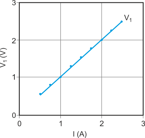

Fortunately, the supply, IP, is nearly proportional to the op amp's output current. So the value of RC in Figure 2 is such to yield the right value at the maximum current of 2.5 A. This simple, one-point adjustment corrects the gain error. Figure 4 shows the result after this gain compensation. Now, the error between the measured V1 and the desired value is within 5%, which is tolerable for many applications. Measurements show that the accuracy holds for input voltages of 5 to 25 V and an additional supply voltage of 2 to 15 .
Gain compensation by adjusting RC improves the accuracy of the measurement.
Figure 4. Gain compensation by adjusting RC improves
