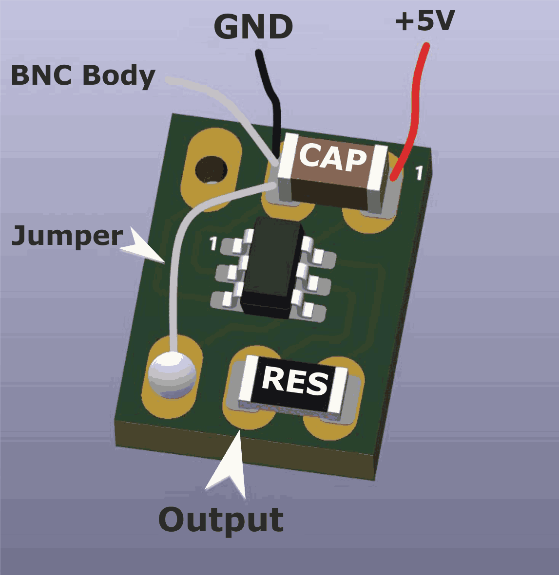

The PCB is a 6 pin SOT-23 adapter available from various sources. As you can see in Figure 4, there are only a few things to solder to the PCB including a jumper. Three wires are attached including the +5 V and ground from the USB cable. The other ground wire needs to be soldered to the BNC body. To do this, I had to break out the old Radio Shack 100 W soldering gun to get enough heat on the BNC base by the solder cup. Scratching up the surface also helped. The PCB is then attached to the BNC by soldering the output pad of the PCB (backside) to the BNC solder cup.
