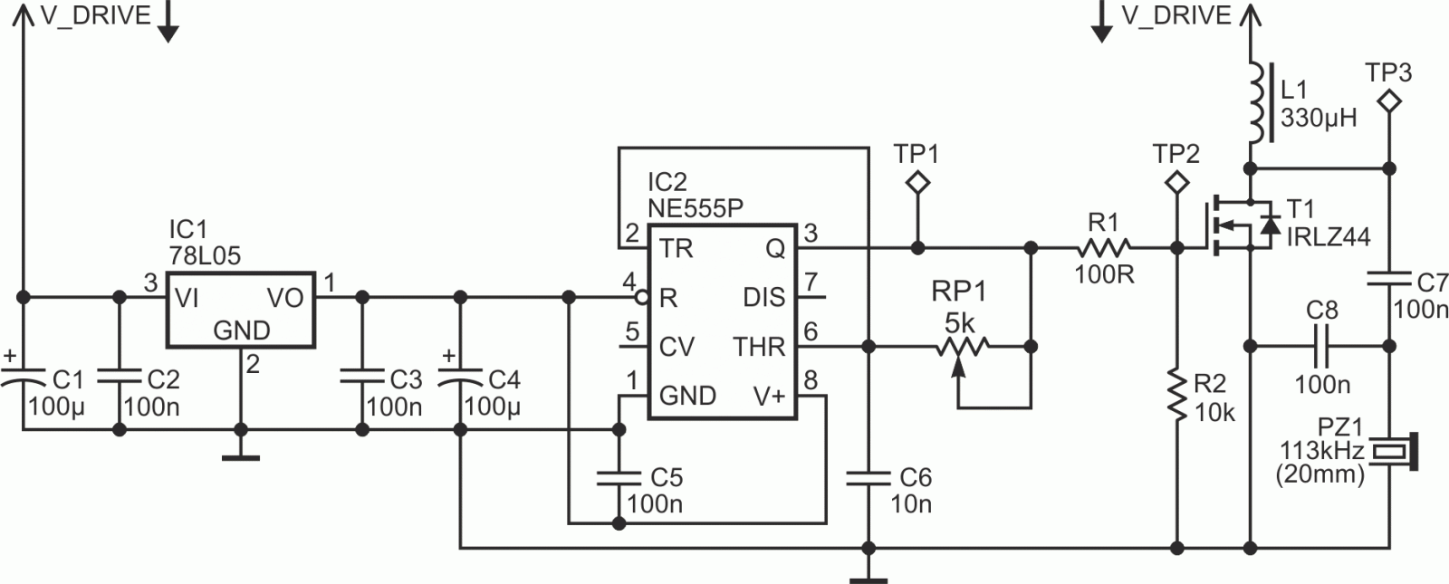

Transducer driver circuit
In Figure 2 is the circuit diagram of the final part of the project – the transducer driver. As shown in the circuit diagram, it’s a tricky oscillator design based on the ubiquitous tiny time chip NE555P (IC1) to generate proper drive pulse train for the atomizer transducer. In the circuit, the 5K multiturn trimpot (RP1) can be used to set the oscillator frequency to 113 kHz (±5 kHz) (TP1). Even though the ultrasonic mist maker device is configured to run on a single 5-Vdc to 12-Vdc input, this transducer driver needs a 20-Vdc to 26-Vdc (V_DRIVE) power supply channel in addition to a 5-V regulated DC supply rail. So a dedicated power supply circuitry will be introduced later to fulfill that crucial requirement.

Because the circuit diagram is very simple and self-explanatory, I’m moving on to the rest of the project without giving a detailed circuit description. In Figure 3, you can see two oscillograms (TP2 & TP3) captured while I was running my ultrasonic mist maker prototype wired on a piece of common circuit board.

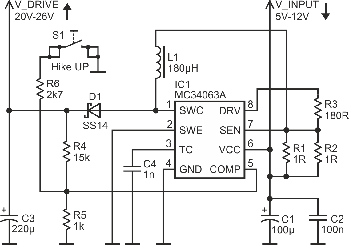

Power supply circuit
The power supply circuit (Figure 4) is a DC/DC boost converter regulator wired around the inexpensive and very popular eight-pin chip MC34063A (IC1). Here, its nominal output is trimmed to 20 Vdc by components R4 and R5. This circuit strictly follows the application example given in the datasheet, so you can tweak it if necessary.
The power supply circuit.
Figure 4. The power supply circuit.
All electrolytic capacitors in the above two circuits are 40-Vdc–rated, while the 180-µH (180 µH to 220 µH) inductor (L1) is a 1-A “drum core”-type one. A small heatsink is necessary for the logic-level power MOSFET IRLZ44 (T1). Note that the power supply section is tailored deliberately to power up the entire ultrasonic mist maker comfortably from an external USB standard power supply. It accepts DC input in the 5-V to 12-V range from any another power source, such as a proper battery and/or wall adapter.
The optional momentary push switch (S1) in association with the 2K7 resistor (R6) lets you hike up the mist density for a short time only if desired. Note that when you push and hold S1, the final output voltage (V_DRIVE) will raise up to 26 Vdc until it gets released.

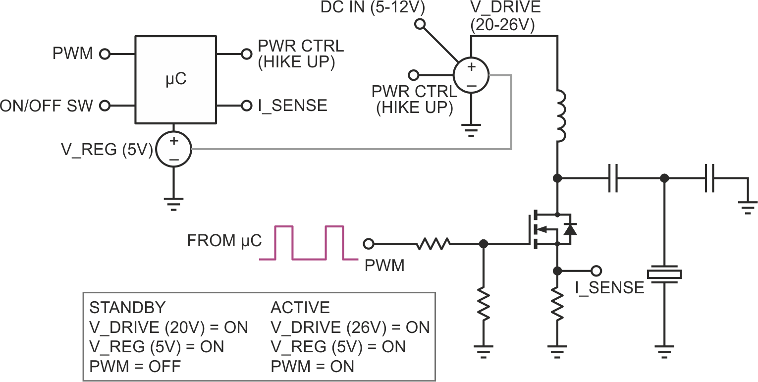

Actually, what I’d designed just after the idea spark is a microcontroller-compatible transducer driver circuit (see the blueprint in Figure 6.
The microcontroller-compatible transducer driver circuit.
Figure 6. The microcontroller-compatible transducer driver circuit.
Because my real intention is to develop and publish a salable design, I’m sure that a microcontroller at its core will give more flexibility and convenience. I don’t want to overkill an Arduino (or Attiny/STM flakes) for the task, but I’d like to try an inexpensive Chinese one-time programmable (OTP) microcontroller (like the PMS150 by Padauk). Although I don’t have a lot of experience with OTP microcontrollers yet (and hence opted for a 555 circuit), I’ll come up with an improved version of my ultrasonic mist maker for sure.
