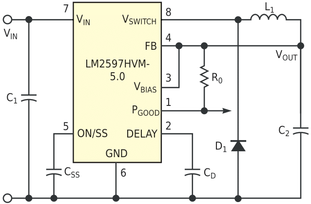

Industrial-control circuits often derive their power from widely varying sources that can exceed the 40 V maximum rating of popular switching ICs. This Design Idea presents a simple, flexible, and inexpensive buck switcher that converts an input voltage as high as 60 V to 5 V at several amps. The circuit is unique in that it boosts current with almost no compromise in performance, size, or cost. It should be of interest to anyone who has ever searched for a simple step-down switcher with an output current or input voltage exceeding that of off-the-shelf devices. Such a search usually entails a far more complex and costly solution than the one this Design Idea presents. LM2594HV and LM2597HV both feature 60 V maximum input, 150-kHz operation, 0.7 A peak output, and on/off capability. The 2597 adds soft start, delay, a power-good flag, and a pin you can use to bootstrap most of its bias current from VOUT. Although both devices are single-chip switchers, you can also use them as driver-controllers with only slight modifications to their standard buck-regulator circuit configurations. Figure 1 shows the 2597HVM in a typical 5 V, 0.5 A configuration that uses all the IC's features. Figure 2 shows the higher current configuration with only three additional components to boost output current to more than 6 A.

Figure 1. This classic buck-regulator circuit efficiently steps down voltage.

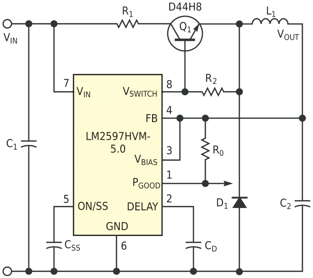

You can increase output current more than tenfold with the addition of only three components.
Figure 2. You can increase output current more than tenfold with the addition
As a bonus, the circuit in Figure 2 also provides overcurrent and short-circuit protection for Q1. The rugged self-protection features of the IC also apply to Q1, provided that the transistor has sufficient heat sinking; L1 stays out of saturation if you select R1 properly. If the peak current in R1 produces a voltage drop large enough to cause Q1 to saturate, then the IC experiences an overcurrent condition, causing its internal protection modes either to disable the switch for the remainder of the pulse period or to skip pulses. Q1 needs to be a fast switch to minimize switching losses. The transistor also needs to have minimal storage time to avoid pulse skipping at low duty cycles. Table 1 shows circuit performance at its maximum input voltage, 60 V , under a variety of output conditions. The table also includes component values and ratings necessary to select sources for L1, C1, and C2.

Efficiency for test conditions of VIN = 60 V and IOUT = 2 to 6 A measures 77% for VOUT = 5 V and rises to 87% for VOUT = 12 V. Efficiency is highest for the VIN range of 30 to 40 V, where its peak is 2% higher than the values in Table 1. Power dissipation is almost evenly divided among L1, D1, and Q1, so you should space these components to avoid hot spots and provide heat-sinking for as much as 3 W each at maximum current and voltage. A good layout should include lots of ground plane and short, wide traces on high-current paths. Output voltages other than 3.3, 5, and 12 V are also available by substituting the adjustable version of the 2597. This IC requires an added resistor pair from VOUT to the FB pin to ground. Calculate resistor-divider values to set the FB pin at 1.23 V for the desired output voltage. Although this design example uses the LM2597HVM-5.0, you can easily apply this current-boost technique using only three additional parts to any of buck devices, effectively extending their output-current capability more than tenfold. You need not use HV devices for applications with a maximum input voltage lower than 40 V.
