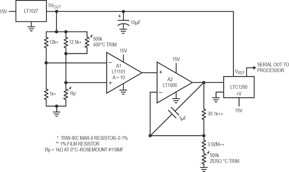

The previous example relies on analog techniques to achieve a precise, linear output from the platinum RTD bridge. Figure 2 uses digital corrections to obtain similar results. A processor is used to correct residual RTD nonlinearities. The bridges inherent nonlinear output is also accommodated by the processor.
Digitally linearized platinum RTD signal conditioner.
Figure 2. Digitally linearized platinum RTD signal conditioner.
The LT1027 drives the bridge with 5 V. The bridge differential output is extracted by instrumentation amplifier A1. A1’s output, via gain scaling stage A2, is fed to the LTC1290 12-bit A/D. The LTC1290’s raw output codes reflect the bridges nonlinear output versus temperature. The processor corrects the A/D output and presents linearized, calibrated data out. RTD and resistor tolerances mandate zero and full-scale trims, but no linearity correction is necessary. A2’s analog output is available for feedback control applications.
