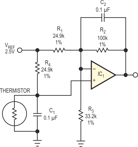

This pseudologarithmic thermistor signal conditioner uses a single  operational amplifier and a few passive components.
Figure 2. This pseudologarithmic thermistor signal conditioner uses a single
In contrast, the signal-conditioning circuit in Figure 2 mitigates the thermistor's inherent nonlinearity by generating a compensating, pseudologarithmic response function that's Curve C in Figure 1 represents. The following equation relates the circuit's ±10 V output span for an ADC ±10 V input span to thermistor resistance RT:
Curve D in Figure 1 shows the resultant resolution curve. Maximum resolution occurs at a temperature that corresponds to a thermistor resistance equal to R4 and an output voltage of 0 V. Although selection of this value optimizes resolution in the middle of the measurement range, the thermistor's nominal resistance is relatively noncritical. You can also select a different value of reference voltage, VREF, to shift the ±10 V output span to meet other requirements. For best performance, you can share the same reference source for VREF and for the measurement system's ADC, which makes measurements ratiometric and thus insensitive to reference-voltage drift.

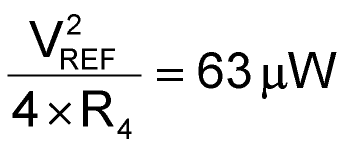

In the circuit in Figure 2, the power dissipated due to thermistor's self-heating reaches a maximum at midspan – that is, when output voltage is 0 V and equals:
for the component values illustrated. For all but the smallest thermistors, this level of self-heating produces acceptably low fractional-degree errors.
