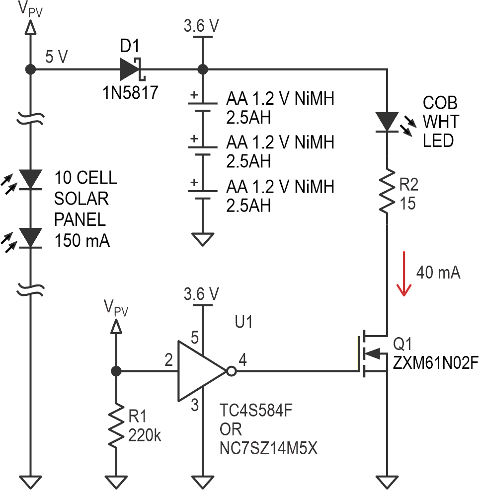

The control circuit I used is shown in Figure 7. A 1N5817 Schottky diode is wired between the solar panel and the battery pack. The diode prevents current from leaking back into the panel at night. A Schmitt trigger IC monitors the voltage across the solar panel and turns on the LED at night. A 15 ohm resistor limits the LED current to about 50 mA. I used a 10 cell, 5 V solar panel, rated at 160 mA.

If you want to increase the light intensity of the jar light, you could install a much larger 10 cell 5 V solar panel, rated at 600 mA. Using this light, you can use 6 NiMH cells, wired in a series/parallel pack, forming a 3.6 V pack with a rating of 5 amp-hours. You could then increase the LED current to about 200 mA with a 3.3 Ohm series resistor. The result a very bright light indeed, enough to light a whole room. However, at the higher current level, I suggest mounting the LED to a section of aluminum plate to act as heat sink.
