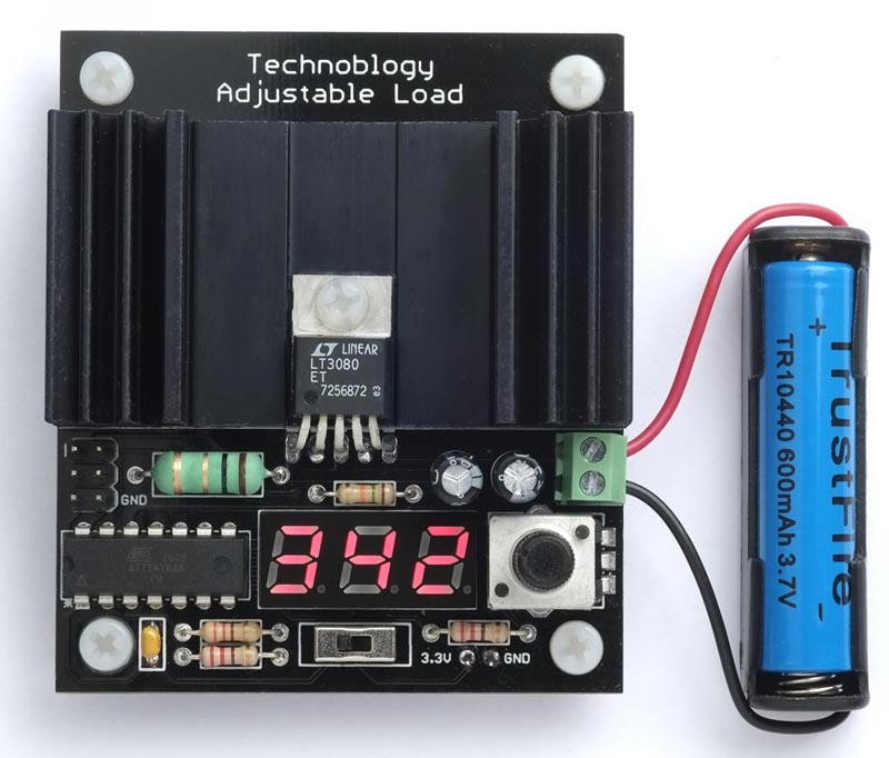

An adjustable load in Figure 1 provides a constant-current load for testing power supplies and batteries. It allows you to set the load current to up to 1.05 A, using a potentiometer, and displays the current on a three-digit LED display controlled by an ATtiny84.
The Adjustable Load, based on an LT3080 regulator and an ATtiny84A processor, drawing 1 A from a power supply being tested.
Figure 1. The Adjustable Load, based on an LT3080 regulator and an ATtiny84A
As well as testing power supplies, the adjustable load can be used for testing rechargeable NiMH and Li-ion batteries under different load conditions. It measures the current over time, and displays the battery's capacity in mA·h or A·h. This is useful for comparing different makes of battery, or for deciding whether a battery has reached the end of its life.

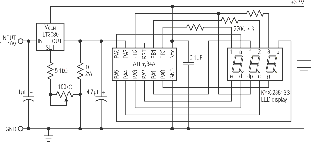

The full circuit of the adjustable load is shown in Figure 2.
Circuit of the adjustable load, based on an LT3080 regulator and ATtiny84 processor.
Figure 2. Circuit of the adjustable load, based on an LT3080 regulator and ATtiny84 processor.
The constant-current circuit is based on an LT3080 regulator. This uses a current reference of 10 µA, rather than a voltage reference like regulators such as the LM317, and will operate down to 1.5 V and a few mA.
The current is sensed by a 1 Ω resistor, and this is fed to the sense input of the regulator, via a 100 kΩ potentiometer and 5.1 kΩ resistor. Since the current through the potentiometer and resistor is 10 µA, at the potentiometer's maximum setting the voltage across them will be 1.05 V, so the output of the regulator will be maintained at 1.05 V across the 1 Ω resistor, producing a constant current of 1.05 A.
The LT3080 is available in a few different packages. I chose the TO-220-5 package which provides a separate VCON pin, and is convenient to mount on a heatsink.
The current is displayed on a three-digit 7-segment display. I used a 0.28" three-digit common anode seven-segment LED display.
You could power the ATtiny84 and display from the power supply you are testing, via a 3.3 V regulator. However, I decided to use a separate 3.7 V Lipo battery because this gives two advantages: First, it allows you to test inputs down to as low as 1 V. Secondly, it ensures that the microcontroller and display remain powered even when the test supply drops to zero, which is essential for battery testing.
The potentiometer is a 100 kΩ linear type. I used an Alps Alpine RK09K1130C94. Another suitable one is the Bourns PTV09A-4020U-B104. I added the 5.1 kΩ series resistor because I wanted to be able to adjust the current slightly above 1 A.
For the LT3080 to regulate, the VCON voltage must be more than 1.2 V to 1.35 V greater than the output voltage. In some applications this pin can simply be connected to VIN, but here this would limit the minimum voltage that the adjustable load can control to about 2 V. The solution is to connect it to the 3.7 V supply used to power the ATtiny84 and display.
Construction
I designed a PCB in Eagle and ordered boards from PCBWay. I designed the PCB to fit the heatsink I used. This has a thermal rating of 6.8 °C/W. With a current of 1 A at 5 V the voltage across the LT3080 will be 4 V, so the power will be 4 W; the heatsink will therefore be 27.2 °C above the ambient temperature, or typically 47.2 °C. This is safely below the LT3080's recommended maximum operating temperature of 90 °C.
I've provided a 2.35" × 1.25" area of copper on the PCB which you could use as a heatsink. There's a rule of thumb that says that "one Watt of power dissipated in one square inch of two-ounce copper generates a 100 °C temperature rise" [3] so this will only provide a thermal rating of about 34 °C/W and won't be sufficient if you want to run the Adjustable Load at its full current.
The TO-220 LT3080 is designed for vertical mounting so you need to gently bend the leads with a pair of flat-nose pliers to fit the PCB. Attach the regulator to the heat sink and board with an M3 screw and nut.
All the components are through-hole, so it should be easy to solder by hand. Mount the 1 Ω/2 W resistor slightly above the board to improve airflow around it.
The PCB includes space for a 2×3 pin ICSP connector that you can use to program the ATtiny84A. For details see Compiling the program below.
The total current consumption of the controller is about 10 mA; I power it from a small 3.7 V Lipo cell connected to the two terminals and attached to the bottom of the board with a double-sided foam sticky pad. You could alternatively use a pair of 1.5 V AAA batteries in a battery box.

I used the Adjustable Load to compare two 3.7 V lithium 10440 batteries. These are convenient cells to use for projects because they fit in a standard AAA battery holder. One was a PKCELL battery rated at 350 mA·h, and the other was a TrustFire battery rated at 600 mA·h. It seemed a bit implausible that the second manufacturer managed to squeeze nearly twice the capacity from the same size of cell.
For each cell, after fully recharging it, I connected it to the Adjustable Load with the current set to 0.70 A. After about half an hour each cell had stopped producing a current through the load, and the displays switched to showing the capacity (Figure 3).
Using the adjustable load to measure the capacity of a rechargeable battery.
Figure 3. Using the adjustable load to measure the capacity of a rechargeable battery.
The PKCELL showed a capacity of 334 mA·h, which is close to the rated capacity, but the TrustFire battery showed a capacity of 342 mA·h, which was what you might expect from its size, but well below its advertised capacity of 600 mA·h.
