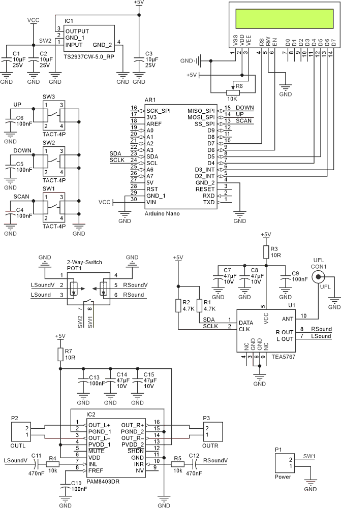

Figure 1 shows the schematic diagram of the device. As it is clear, the circuit consists of 3 main parts: Arduino-Nano (Controller), FM receiver module, and the audio amplifier.
Schematic diagram of the digital FM receiver.

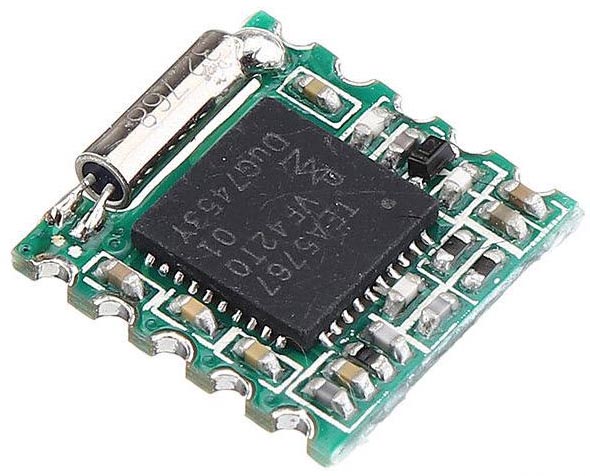

FM receiver module
The FM receiver module is based on the TEA5767 chip. It is a well-known module that could be controlled via the I2C bus. It covers the FM frequency range from 76 MHz to 108 MHz. At the output, it handles L and R stereo audio signals that should be amplified, otherwise, the sound level is weak and can not be heard even by an earphone. The frequency selection and signal-strength measurement tasks are performed by the Arduino-Nano code.
R3, C7, C8, and C9 build a first-order low pass RC filter that reduces the supply noise. R1 and R2 are mandatory pull-up resistors for the I2C bus and CON1 is a UFL connector that provides an antenna connection. Figure 2 shows the TEA5767 module.
The TEA5767 FM receiver module.
Figure 2. The TEA5767 FM receiver module.

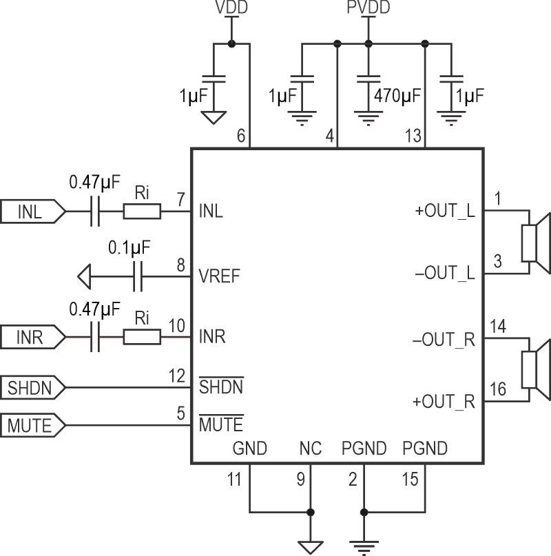

Audio amplifier
The audio amplifier part consists of the PAM8403 chip. This chip is a 3 W+3 W Hi-Fi Class-D amplifier that can operate with only a single 5 V supply. The maximum output power can be achieved using 4-ohm speakers. According to the datasheet: “The PAM8403 is a 3 W, class-D audio amplifier. It offers low THD+N, allowing it to achieve high-quality sound reproduction. The new filterless architecture allows the device to drive the speaker directly, requiring no low-pass output filters, thus saving the system costs and PCB area”.
C13, C14, and C15 are bypass capacitors that are used to reduce the supply noise. R4, R5, C11, and C12 are used to transfer the output audio to the amplifier. Figure 3 shows the reference circuit of the PAM8403 chip. P2 and P3 are right-angle 2-pin XH connectors that are used to connect the speakers to the board.
Datasheet reference circuit of the PAM8403.
Figure 3. Datasheet reference circuit of the PAM8403.

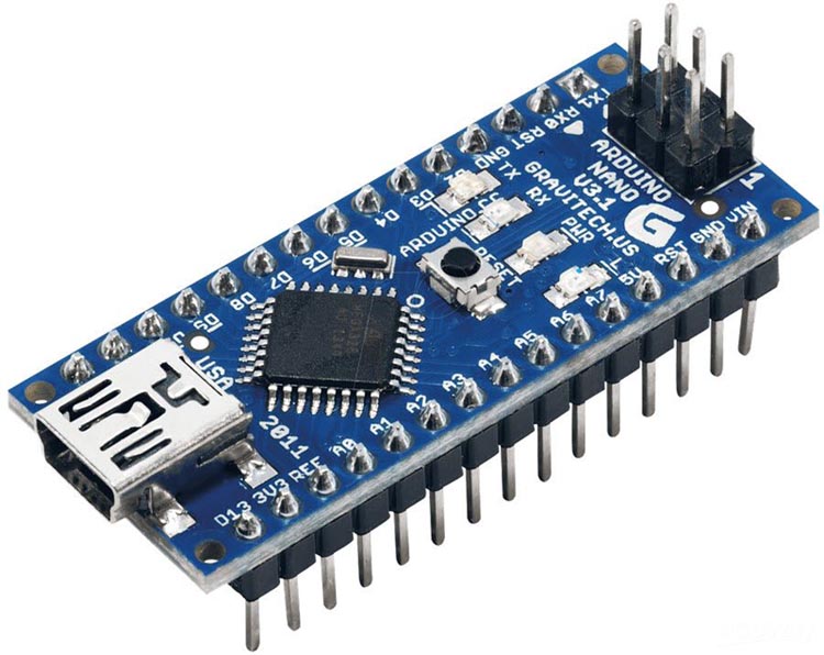

Controller
The controller of the circuit consists of an Arduino-Nano board (AR1). Figure 4 shows the Arduino-Nano board. The board drives an 8×2 LCD (LCD1) and also reads the status of the SW1, SW2, and SW3 push buttons. It also sends/receives the TEA5767 data through the I2C bus. R6 sets the contrast level of the LCD and C4, C5, and C6 are used to reduce the mechanical push-button noises (debouncing).
The Arduino-Nano board.

Power supply

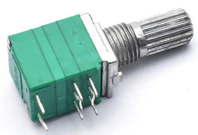

The TS2937 is the main component of the power supply that provides a stable +5 V supply for the circuit. C1, C2, and C3 are used to reduce the noise, and POT1 is a 50K 2-way (dual) potentiometer with a switch. The POT1 both turns ON/OFF the device and increases or decreases the sound level. Picture 5 shows a picture of the POT1.
2-Way (Dual) potentiometer with switch.
Figure 5. 2-Way (Dual) potentiometer with switch.

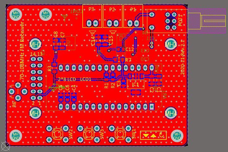

PCB layout
The PCB layout of the digital FM receiver.
Figure 6. The PCB layout of the digital FM receiver.

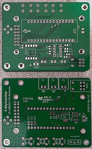

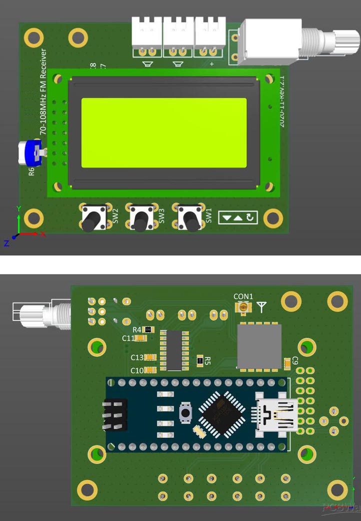

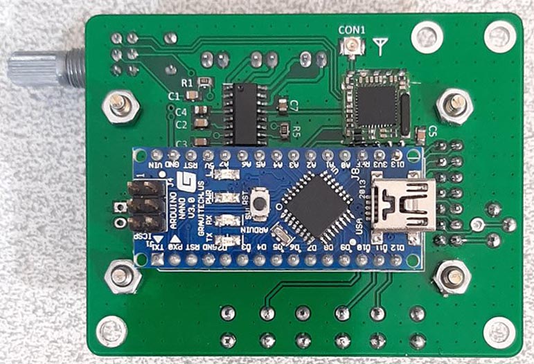

Figure 6 shows the PCB layout of the digital FM receiver. It is a 2 layers PCB board, last revision. The Arduino-Nano board is mounted on the bottom side and LCD on the top side of the board, preferably on female pin headers. This is more clear in 3D views and real photos. Figure 7 shows the 3D views of the board. Figure 8 shows the high-quality fabricated PCB boards of the digital FM receiver circuit.
The top and bottom 3D views of the PCB board.
Figure 7. The top and bottom 3D views of the PCB board.
High quality fabricated PCB boards.
Figure 8. High quality fabricated PCB boards.

The smallest component package is 0805. You should not have any problem with soldering the board. Figure 9 shows the assembled PCB board from the top and Figure 10 shows the assembled PCB board from the bottom. The board has been hand-soldered by me. You would also need four 5 mm FF spacers to fix the LCD on the PCB board.
Assembled PCB board (top view).
Figure 9. Assembled PCB board (top view).
Assembled PCB board (bottom view).
Figure 10. Assembled PCB board (bottom view).

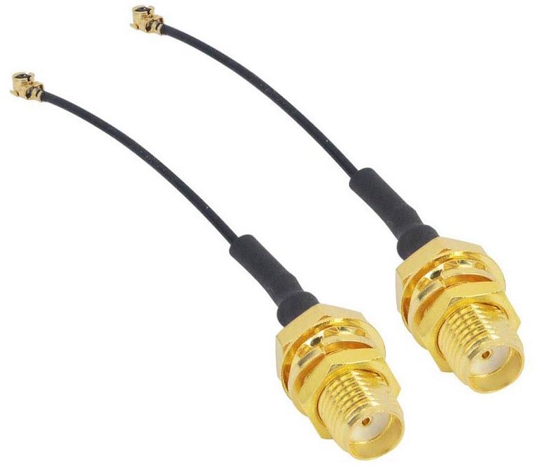

You should use a UFL to SMA-F connector to connect your antenna to the board. Figure 11 shows this type of connector.
UFL to SMA-F connector.
Figure 11. UFL to SMA-F connector.

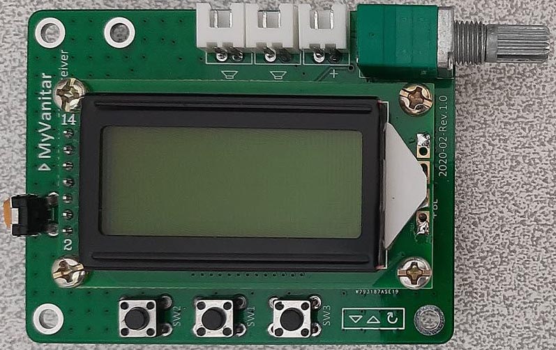

The lower limit of the frequency is 76.0 MHz and the upper limit is 108.0 MHz. You can increase or decrease the frequency by 0.1 MHz by pressing the Up and Down buttons. Similarly, if you long-press these buttons, the frequency will be increased/decreased continuously. So it is pretty easy to fix the receiver on your desired frequency (FM station). Moreover, the Scan button can automatically search for powerful-enough FM stations and fix the receiver on the frequencies. To search for the next station, you should press the Scan button again.
The strength of the FM signal is displayed on the LCD screen as a bar graph. In Figure 12, the receiver has been set on a powerful FM station, at 100.0 MHz frequency.
The receiver has been set on a powerful FM station at 100.0 MHz frequency.
Figure 12. The receiver has been set on a powerful FM station at 100.0 MHz frequency.
