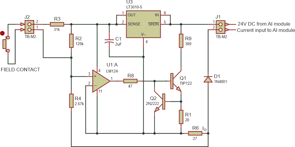

Figure 1’s circuit provides an economical and reliable solution for distinguishing between a cable open and a field contact open. This circuit outputs 4 mA for contact open, 20 mA for contact closed, and 0 mA for cable open. This small module may be placed very close to the field contact. The contact status may be read by an analog input module instead of a digital input module.
The current output (IO) is given to the analog inputs of the DCS/PLC. R7 is the load inside of the analog input module of the DCS/PLC.

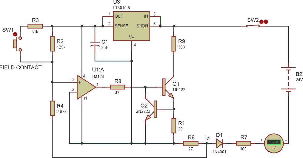

The circuit in Figure 1 is for testing. SW1 can be operated to set the field contact to closed or open. The output current (IO) is around 4 mA for open field contact, 20 mA for a closed field contact, and 0 mA for cable open. SW2 is operated to create an open cable condition.
Precise values are not necessary; hence, precision components are not needed. The PLC/DCS needs to be programmed to read around 0 mA, 4 mA, and 20 mA to decode cable open, contact open, and contact closed conditions.
Figure 2 shows the interface module housing the above circuitry. You do not need a separate power supply for this module, as it takes power from PLC/DCS. The connection of this module to the field contact and the analog input of the PLC/DCS is shown here.
The interface module circuit and connection to the field contact. The DCS/PLC's analog input is also shown.
Figure 2. The interface module circuit and connection to the field contact. The DCS/PLC’s analog input is also shown.
