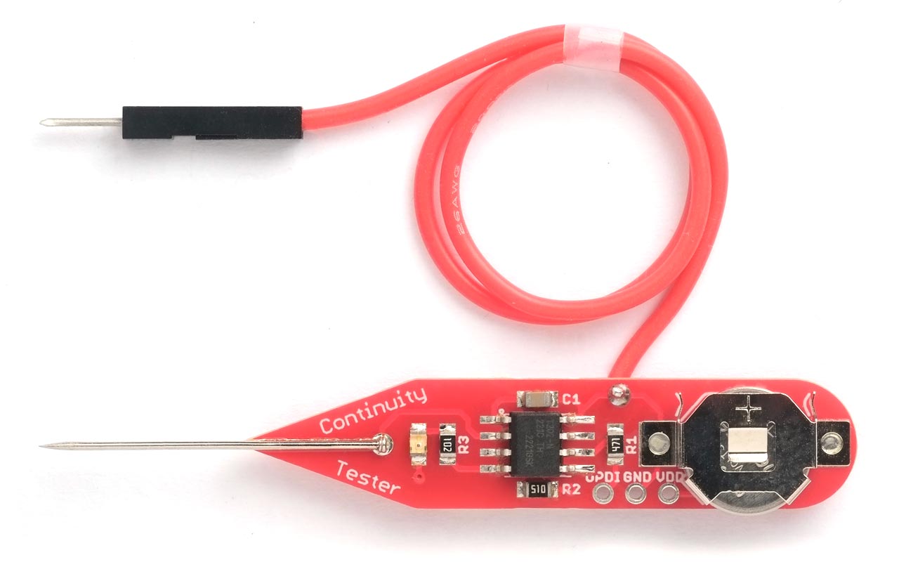

Figure 1 shows a simple tester, based on an ATtiny202, a piezo buzzer, and an LED, for checking circuit wiring or tracing out the tracks on a PCB:
The Tiny Continuity Tester based on an ATtiny202. The piezo speaker is on the reverse of the board.
Figure 1. The Tiny Continuity Tester based on an ATtiny202. The piezo speaker is
It has a low threshold resistance of 50 Ω to avoid false positives, and passes less than 0.1 mA through the circuit under test, to avoid affecting sensitive components. It's powered from a small button cell, and automatically switches itself off when not in use, avoiding the need for an on/off switch.

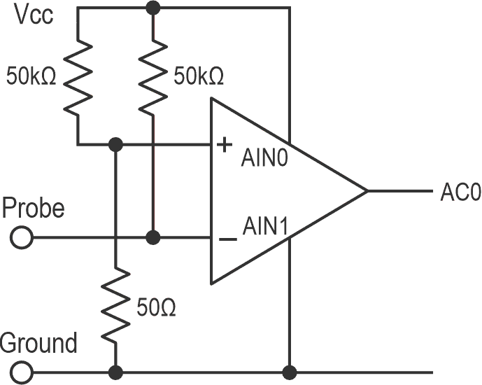

The Continuity Tester uses the Analog Comparator in the ATtiny202 to detect the voltage on the probe. The circuit is equivalent to the circuit in Figure 2.
Equivalent circuit of the Tiny Continuity Tester using the ATtiny202 analogue comparator.
Figure 2. Equivalent circuit of the Tiny Continuity Tester using
When the voltage on the positive pin AIN0 is higher than the voltage on the negative pin AIN1, the Analog Comparator output, ACO, is set. Assuming a 3 V supply, the voltage at AIN1 is held at 3 V by the pullup resistor, and the voltage at AIN0 is held at 3 mV by the resistor divider. If the resistance between the probe and ground becomes less than 50 Ω, the voltage on AIN1 will be lower than the voltage on AIN0, taking the output of the comparator high. This is then used to enable the oscillator driving the piezo speaker.
The advantage of using the analog comparator rather than a regular digital input is that it allows us to precisely set the point at which the input will be triggered.
In fact the two pullup resistors are unnecessary, as we can use the internal pullups on the inputs corresponding to AIN0 and AIN1. This has two benefits; first, it saves two resistors, but more importantly, it allows us to turn off the pullup on AIN0 when the processor goes to sleep, avoiding the current drain through the 50 Ω resistor.

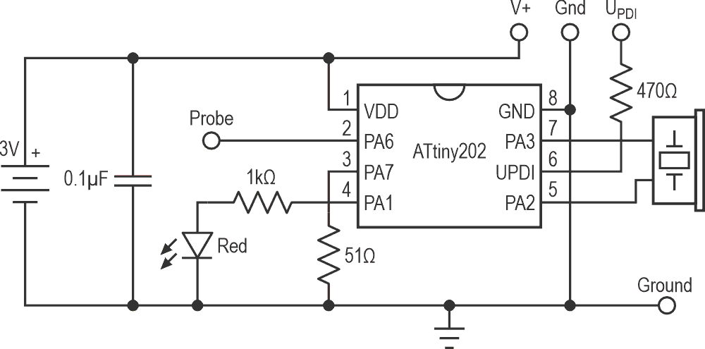

The complete circuit of the ATtiny202 version of the Tiny Continuity Tester is shown in Figure 3.
Circuit of the ATtiny202-based Tiny Continuity Tester.
Figure 3. Circuit of the ATtiny202-based Tiny Continuity Tester.
Processor
The circuit will work with any 8-pin device in the ATtiny 0-series or 1-series, from the ATtiny202 up to the ATtiny402, ATtiny212, or ATtiny412.
These processors are rated down to 1.8 V at a clock rate of 5 MHz or lower; for this circuit I've specified a clock of 1 MHz to minimise power consumption.

Construction
For the final version I designed a board in Eagle.
Components

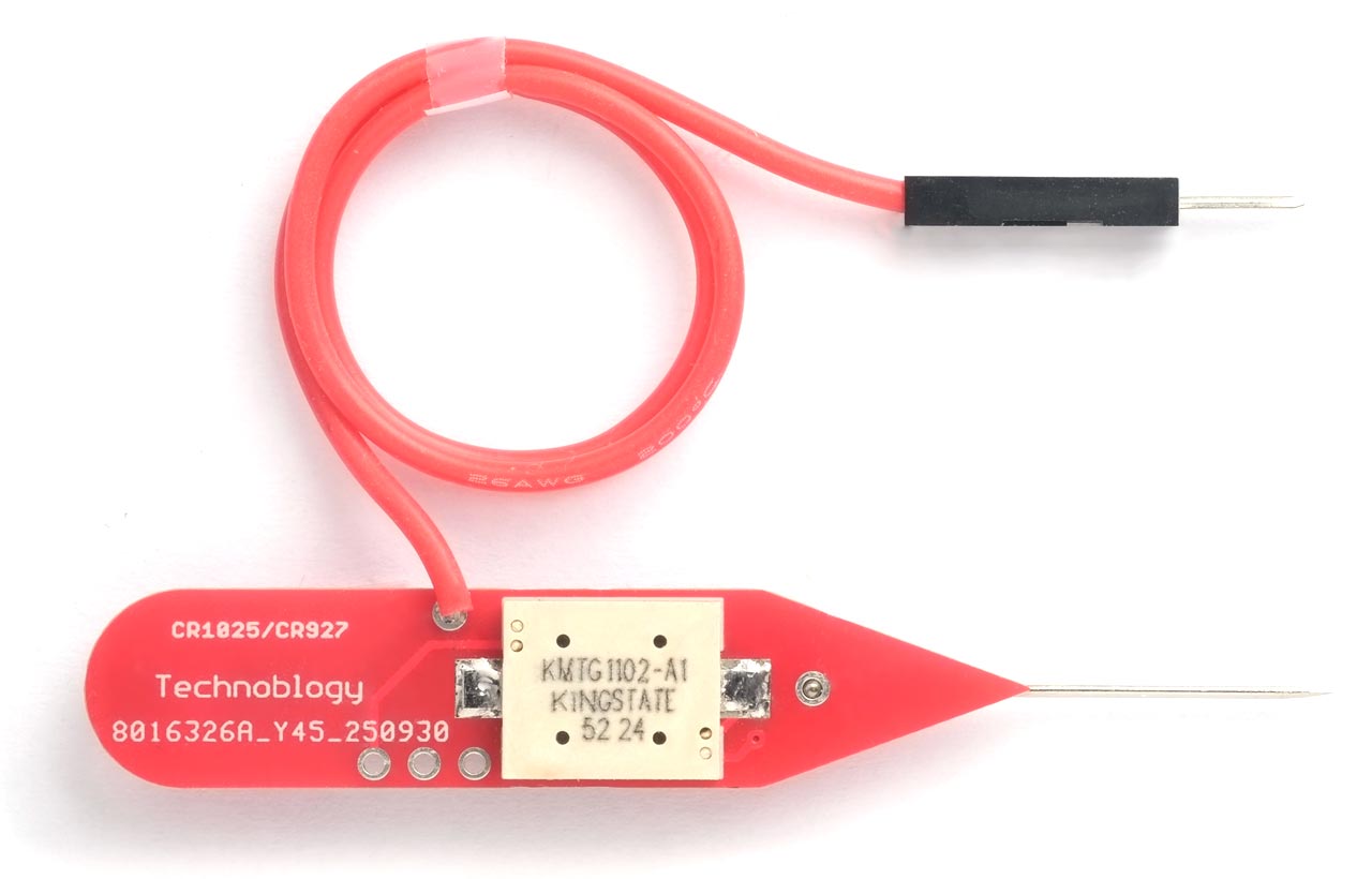

All the components are on the front of the board, apart from the piezo speaker which is on the back (Figure 4).
The back of the completed Tiny Continuity Tester showing the piezo speaker.
Figure 4. The back of the completed Tiny Continuity Tester showing the piezo speaker.
The ATtiny202 is in an SOIC package, and the resistors and LED are 0805 SMD components, so they should be fairly easy to solder by hand.
I used a Miniware MHP50-B5 50 × 50 mm hotplate set to 235 °C to solder the components on the front of the board after applying dots of Chip Quik SMD291AX10T3 solder paste to the pads with a pin. I then soldered the piezo speaker on the back with a soldering iron.

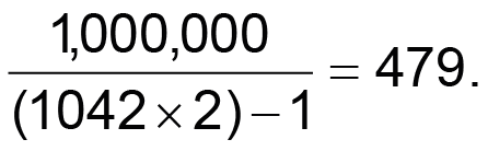

  TCA0.SINGLE.CMP0 = 479;                                  // Gives 1042Hz (C6)
One side of the piezo speaker is connected to PA3, the waveform output WO0 from the Timer/Counter. I chose the frequency that sounded loudest through the piezo speaker I was using, 1042 Hz (C6). To get this frequency with a 1 MHz clock, the compare value you need to put in the compare register CMP0 is:

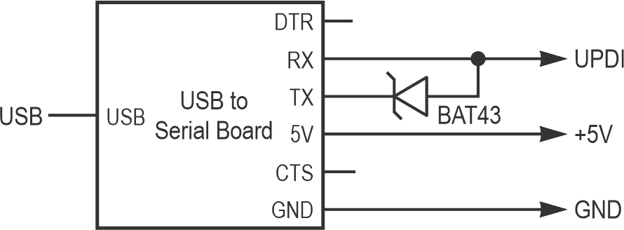

To program the processor the recommended option is to use a 5 V or 3.3 V USB to Serial board, such as the SparkFun FTDI Basic board, or a USB to Serial cable, connected with a Schottky diode as shown in (Figure 5). You can substitute a 4.7 kΩ resistor for the Schottky diode:
Serial UPDI programmer.
Figure 5. Serial UPDI programmer.
Connect the +5V/+3.3V, GND, and UPDI pins to the three terminals on the bottom edge of the Walkie-Textie. I held three pins in contact with the terminals to avoid the need to permanently solder a header to the board. If there's a coin cell in the board leave the +5V/+3.3V connection unconnected. Proceed as follows:
  • Set Programmer to "SerialUPDI - 230400 baud".
  • Select the USB port corresponding to the USB to Serial board in the Port menu.
  • Choose Upload from the Arduino IDE Tools menu to upload the program.
