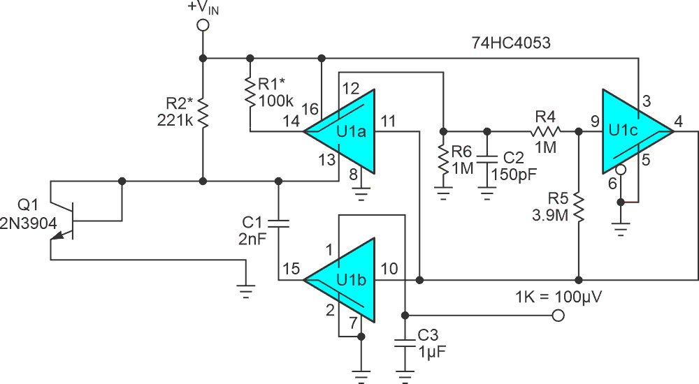

(Here CR is current-ratio.) So, if we need any given ΔVBE/°C, the required
For example, for ΔVBE/°C = 100 μV,
This ratio is implemented in Figure 1’s simple circuit for a 100 µV per Kelvin output.
An ordinary BJT Q1 makes an accurate 100 µV per unit Kelvin absolute temperature sensor.
Figure 1. An ordinary BJT Q1 makes an accurate 100 µV per unit Kelvin absolute temperature sensor.

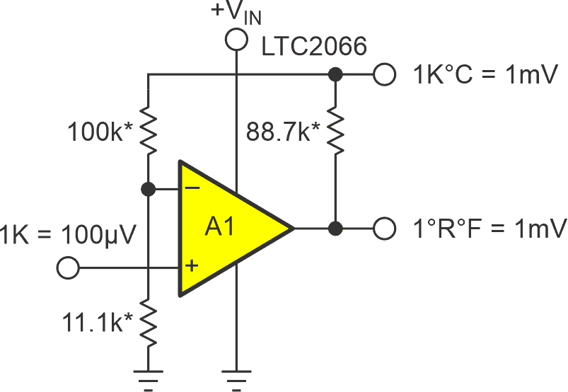

Nick’s favorite sensor is the super-versatile platinum RTD, but as Williams showed, a humble (and super cheap) 2N3904 (or similar) BJT might also fill the bill. That’s assuming that its package-limited –55 to +150 °C temperature range is adequate. And that’s also assuming that it gets a little help from its friends, such as Figure 2’s zero-drift op amp that boosts the output span to a DMM-friendly 1 mV per unit Celsius, Kelvin, Fahrenheit, and Rankine.
A zero drift, 5 µV max offset A1 rescales 100 µV/°K by 10x to 1 mV/°C and by 18x to 1 mV/°F.
Figure 2. A zero drift, 5 µV max offset A1 rescales 100 µV/°K by 10x

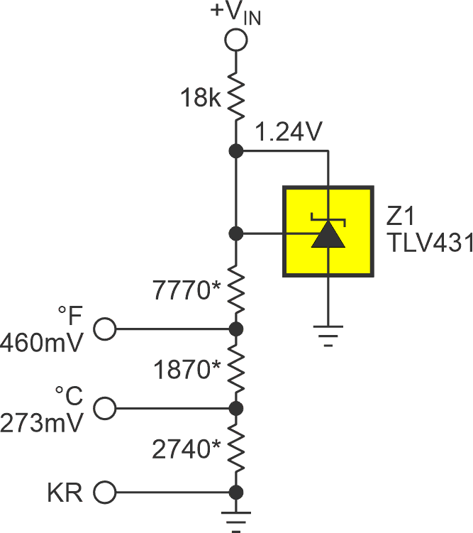

Of course, Kelvin and Rankine absolute temperature measurements are absolutely less frequently useful than the common Celsius and Fahrenheit scales…which is where Figure 3 comes in.
Connect the DMM's plus lead to the appropriate figure 2 output
Figure 3. Connect the DMM’s plus lead to the appropriate figure 2 output,
and the minus lead to the correct precision 0° offset terminal,
to re-zero 273K to 0°C and 460R to °0F.
V+ can be anywhere from 3 to 6 volts. Current consumption at 3 V is barely more than 1 mA, dominated by the Z1 shunt reference, so two AAs will support 2000 hours (nearly three months) of continuous operation. A single CR2032 lithium coin will hold up for 10 non-stop days.
