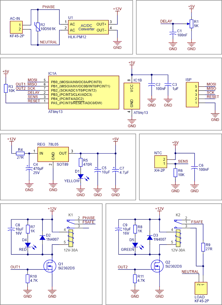

Figure 1 shows the schematic diagram of the device. As it is clear, the heart of the circuit is the ATtiny13 microcontroller.
Schematic diagram of the 30 A AC Soft Starter (Inrush current limiter).
Figure 1. Schematic diagram of the 30 A AC Soft Starter (Inrush current limiter).
I start explaining the schematic from the top. AC-IN is the connector for the AC Mains input. R2 is the 10D5651K varistor to eliminate voltage spikes at the input. U1 is the HLK-PM12 AC to DC module that handles 12 V at the output. This voltage is suitable to drive the Relays. R1 is a 5K potentiometer to adjust the delay. You can adjust the delay to something between 1 ms and 1 s. ISP is a male pin header for the AVR ISP programmer. IC1A and IC1B are parts of the ATtiny13 microcontroller. R3 is a pullup resistor for the RESET pin. C2 and C3 are decoupling capacitors for the VCC pin.
R4 and C4 build an RC filter at the input of the REG1. REG1 is the 78L05 SOT-89 5 V regulator to build a stable 5 V power for the microcontroller. D1 is a 3 mm yellow through-hole LED to indicate a proper supply voltage and R5 limits the current to D1. C5 and C7 are output capacitors to stabilize the regulator output voltage and reduce the noise. NTC is a 2 Pins XH connector to wire a 10K NTC to the board. R6 and NTC build a voltage divider, where voltage variations indicate changes in the temperature. If the temperature increases at the NTC side, the output voltage increases, and vice versa. C6 is a decoupling capacitor to reduce noise.
There are two Relay circuits here, both are identical. I explain one of them. Q1 is a Si2302 MOSFET to drive the K1 Relay. R10 is a pulldown resistor for the Gate pin of Q1 to prevent unwanted triggering of the MOSFET. D2 is a 1N4007 diode to protect the MOSFET against reverse currents of the Relay’s coil. D4 is a 3 mm Red LED to indicate the fault condition. C8 damps the voltage spikes of Relay activation/deactivation. R9 is a 27R-20W power resistor to limit the inrush current, you can use other values depending on your application.

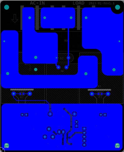

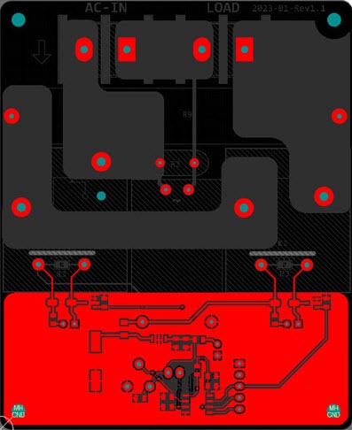

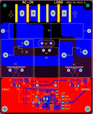

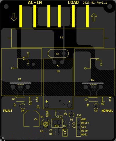

PCB layout
Figure 2 shows the PCB layout of the design. It’s a two layers PCB board and I used a mixture of SMD and through-hole components. In my opinion, component placement is the first rule in a good PCB design. In this PCB, the separation between the power and logic circuits is clear.
PCB layout of the 30 A AC Soft Starter (Inrush current limiter). PCB layout of the 30 A AC Soft Starter (Inrush current limiter).
Figure 2. PCB layout of the 30 A AC Soft Starter (Inrush current limiter).

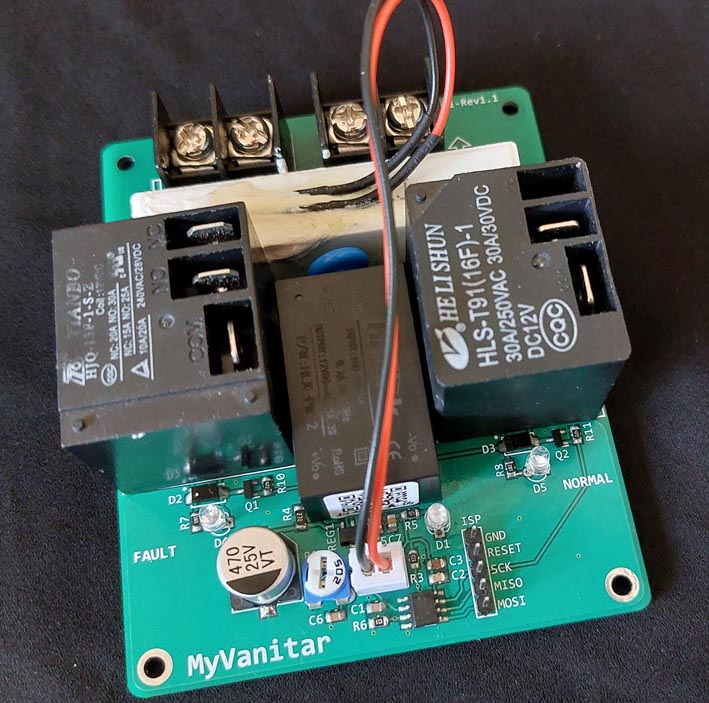

Assembly and test
Figure 3 shows the assembled PCB board. You should wire a small 10K NTC from the board and mount it on the power resistor. The best method to fix the NTC is to use some silicon glue (thermal conductive glue). Simply adjust the potentiometer for your desired delay. Pay attention to the status of 3 LEDs (Yellow, Green, and RED).
Assembled board of the 30 A AC Soft Starter (Inrush current limiter).
Figure 3. Assembled board of the 30 A AC Soft Starter (Inrush current limiter).
