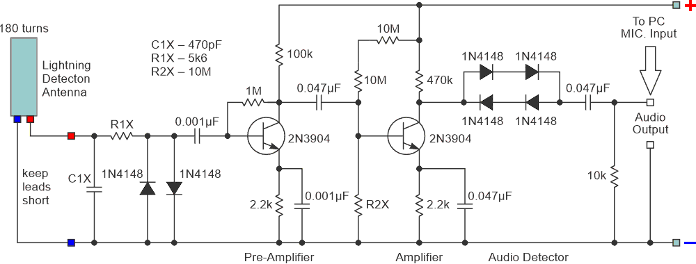

Принципиальная схема детектора молний.
Figure 1. Schematic diagram of a lightning detector.

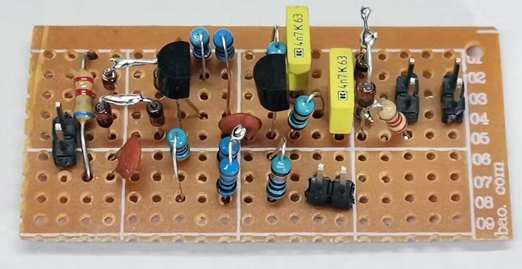

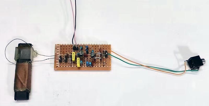

Lightning detector circuit assembled on a breadboard.
Figure 2. Lightning detector circuit assembled on a breadboard.

As I mentioned before, the device is very simple to build and consists of the following components:
  • Two NPN transistors,
  • 6 diodes 1N4148,
  • several resistors and capacitors,
  • detecting coil (180 turns on a ferrite core with a diameter of 1 cm and a length of 10 cm),
  • and a rod antenna from an old pocket radio.

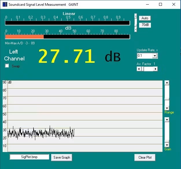

First, we need to connect the output from the detector to the microphone input from the sound card, and then start the software (Figure 4).
Graphical representation of thunderstorm phenomena.
Figure 4. Graphical representation of thunderstorm phenomena.
As for the "SignalMeasure" application, it was downloaded from the G4JNT site (Ref. 1) and is actually an audio amplitude signal monitor. The electronic circuit transforms the thunder into an audio signal, and then this signal is monitored on the PC application. On the application we can set the sampling frequency, and if it is set to 1 sec, the graph shows us the events of the last 8 minutes.

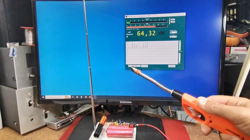

First we will test the device with an electric lighter (Figure 5).
Testing the device using an electric lighter.
Figure 5. Testing the device using an electric lighter.

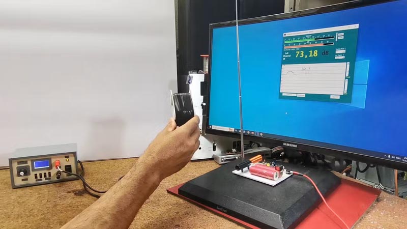

This device is sensitive to magnetic field. To test this feature I am going to use this PEMF device which is actually a variable magnetic field generator (Figure 6).
Testing the device using a PEMF device.
Figure 6. Testing the device using a PEMF device.

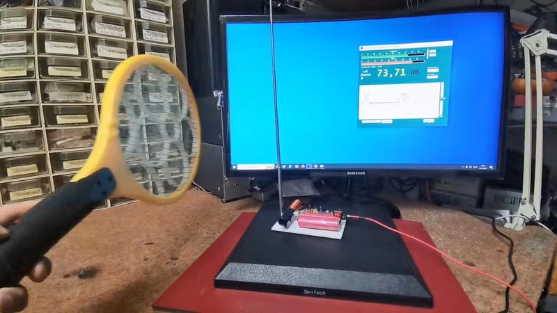

The device is also sensitive to electrostatic charge. As a source of electrostatic charge I use insect killer (Figure 7).
Testing for sensitivity to electrostatic charges.
Figure 7. Testing for sensitivity to electrostatic charges.
