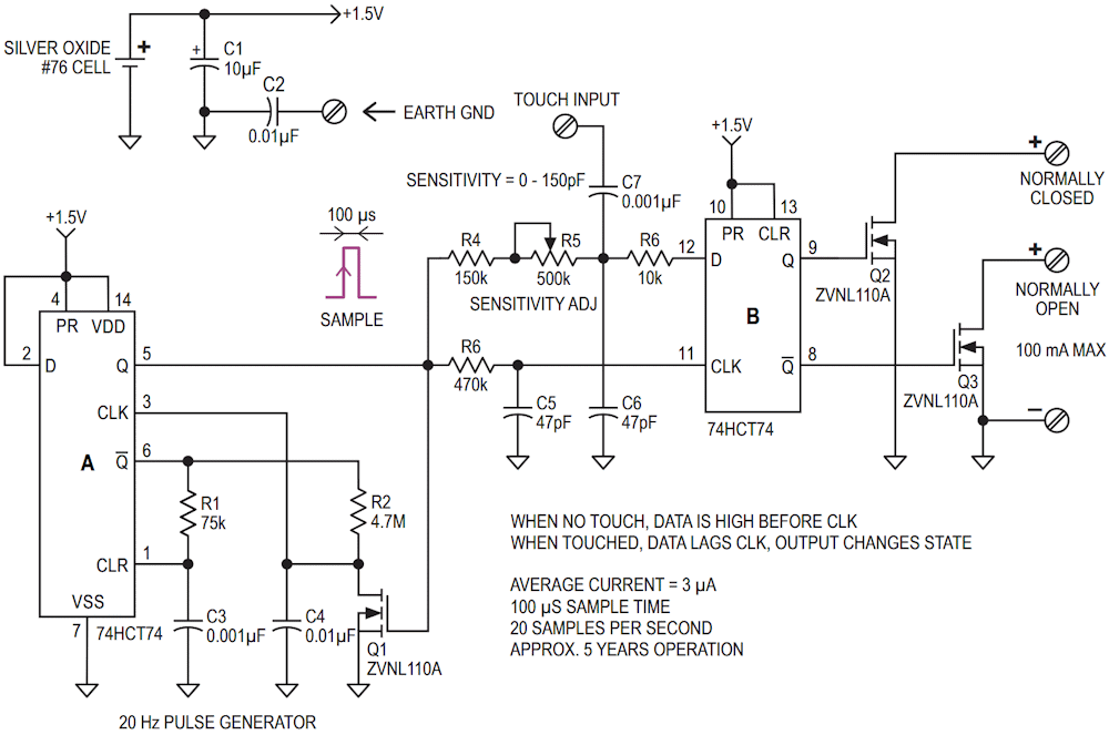

Touch activated switch needs 1.5 volts
Texas Instruments 74HCT74
A single 1.5 V silver oxide button cell powers this complete touch activated switch circuit for 5 years. It features both a normally open and a normally closed set of solid state switch thermals. It also has an adjustable sensitivity, which can be set for a touch capacitance change as small as 1 picofarad.
