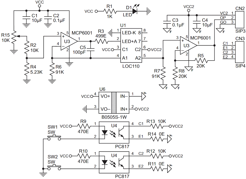

At the core of the design is the LOC110 linear optocoupler, which provides 3750 V isolation. The MCP6001 op-amp (U2) functions as a closed-loop servomechanism, sensing the photodiode current and driving the optocoupler’s LED to maintain accurate linearity. A second MCP6001 (U3) further conditions the phototransistor output. An onboard power LED (D1) indicates the active input-side supply.
The LOC110 incorporates an infrared LED optically coupled to two photodiodes. The feedback photodiode stabilizes the LED current, compensating for nonlinearity, time drift, and temperature variations, while the output photodiode delivers a highly linear, isolated analog signal.

Schematic and connections
Figure 1 shows the schematic diagram of the device.
Schematic diagram of an isolated module.
Figure 1. Schematic diagram of an isolated module.

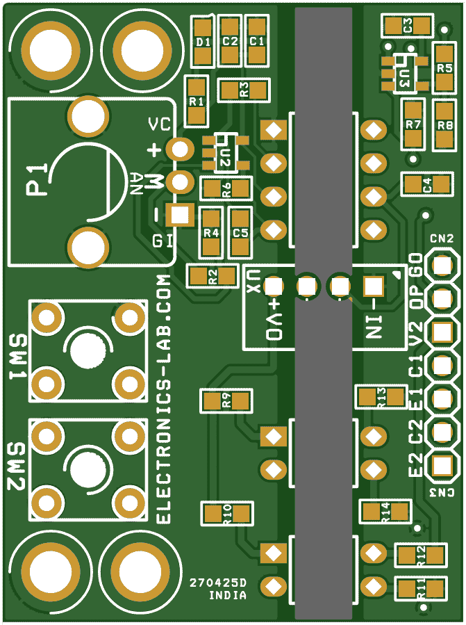

The CSV project files can be downloaded from the link in the Downloads section. The components placement is shown in Figure 2.
The components placement of an isolated module.
Figure 2. The components placement of an isolated module.

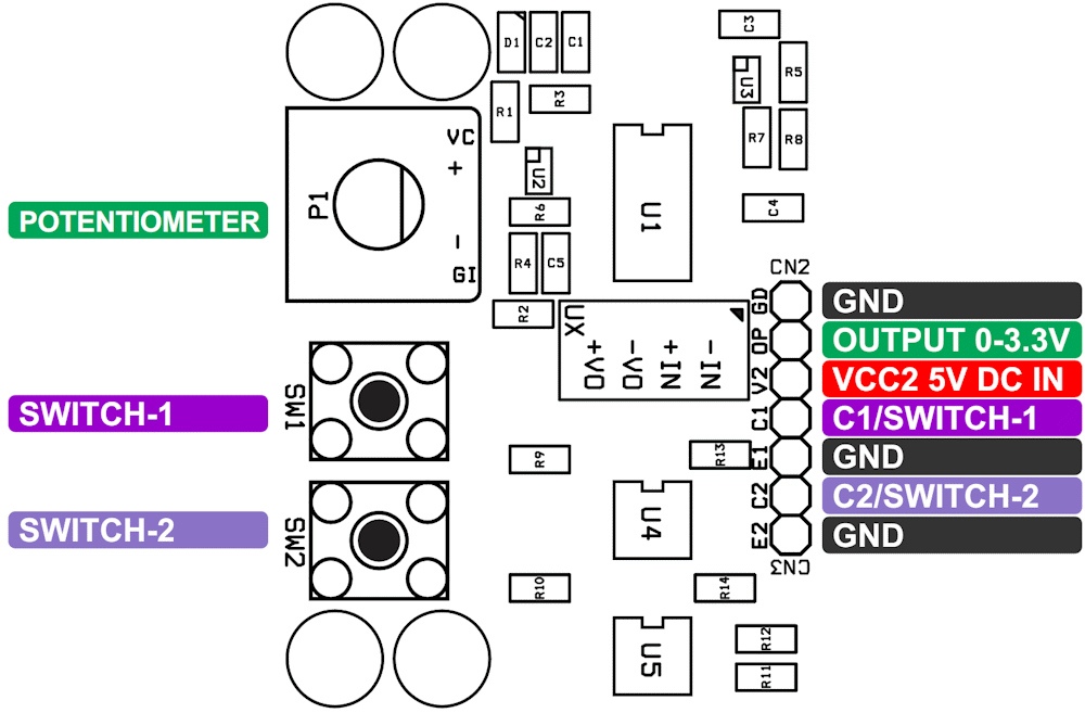

Figure 3 shows the device connection diagram.
The module connection diagram.
Figure 3. The module connection diagram.

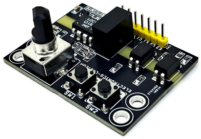

Figure 4 shows the assembled PCB board.
Assembled PCB board of the module. Assembled PCB board of the module.
Figure 4. Assembled PCB board of the module.
