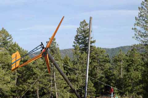

Always test raise the tower before putting anything on it.
Always test raise the tower before putting anything on it. At the top of the tower (along with the top guy wires) we've attached a rope.
When raising, people need to pull on the rope as the tower gets nearly erect to overcome the weight of the gin pole
When raising, people need to pull on the rope as the tower gets nearly erect to overcome the weight of the gin pole, otherwise it will up so high and then the gin pole will 'fall' to the ground making for a rather violent erection. The test raise is always a bit scary. We try to figure our guy wire lengths as accurately as possible but usually we cut/adjust them so the tower is slack on the first raise, and some adjustment is necessary. This is also a good time to mention that a towers guy wires should *always* tighten as it goes up and slack a bit when it goes down. This is accomplished by putting the side anchors a small distance (in this case about 6 inches) in front of the tower (in the direction it the tower tips)
On the first test raise it's important to get the tower plumb, and get the cables properly adjusted.
On the first test raise it's important to get the tower plumb, and get the cables properly adjusted. After that, assuming it does slack on the way down as it should, it should work well and always come back up into adjustment.
Pictured above is detail of the gin pole while raising the tower.
Pictured above is detail of the gin pole while raising the tower. If you look closely you can see a bulldozer in the background. You can see how the cable we pull it up with comes from the ground, through a pulley at the end of the gin pole, back down to the ground through another pulley and then to the tractor.

Very carefully and slowly raise the tower and hope for the best!
Very carefully and slowly raise the tower and hope for the best! Be sure during raising that the turbine is shorted out (the stop switch is 'on') so it can't start running during the process.
This time we had a few folks pulling on the rope to overcome the weight of the gin pole.

Usually when you raise a wind turbine you stop all the wind sometimes for weeks. This time, it was a windy day and it started up immediately, making over 3kW and furling a bit.
