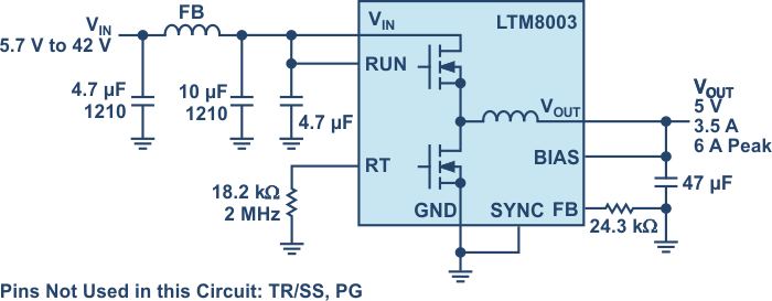

A 5 V converter with a simple EMI filter at the input passes CISPR 25 Class 5.
Figure 1. A 5 V converter with a simple EMI filter at the input passes CISPR 25 Class 5.

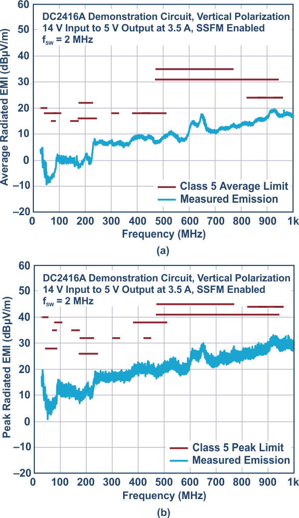

This architecture, combined with spread spectrum frequency operation (SSFM), greatly simplifies the EMI filter design and layout, which is ideal for noise sensitive environments. Figure 1 shows a simple EMI filter on the input side, enabling the demo circuit to pass the CISPR 25 Class 5 standard with plenty of margin, as shown in Figure 2.
DC2416A demonstration circuit passes radiated EMI spectrum CISPR 25 Class 5.
Figure 2. DC2416A demonstration circuit passes radiated EMI

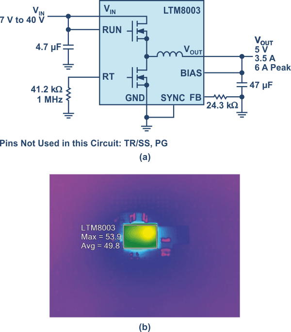

Wide Operation Temperature Range from −40 °C to +150 °C
Automotive, industrial, and military applications require power supply circuits to operate continuously and safely in ambient temperatures over 105 °C or require significant headroom for a thermal rise. The LTM8003H is designed to meet specifications over a −40 °C to +150 °C internal operating temperature range. The internal overtemperature protection (OTP) monitors the junction temperature and stops switching when the junction temperature is too hot.
Figure 3. A 5 V, 3.5 A solution for 7 V to 40 V inputs using the H-grade version.
Thermal imaging shows no need for bulky heat mitigation components.
Figure 3a shows a 3.5 A, 5 V solution that operates from a wide-ranging 7 V to 40 V input. The thermal performance at a nominal 12 V input is shown in Figure 3b. The typical efficiency is above 92% with a 12 V input and 2 A load.

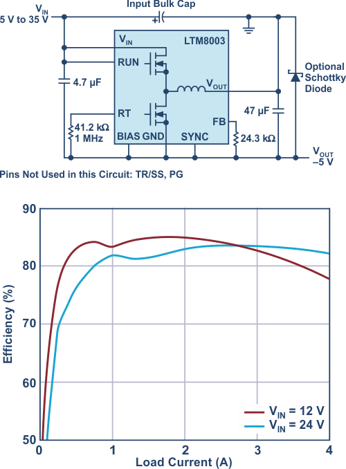

Negative Output −5 V from +3.5 V to +35 V Input
Figure 4 shows a solution for a –5 V, 4 A output from a nominal 12 V input, with a maximum of 35 V input. The BIAS pin should be connected to GND.
A -5 V supply from a +5 V to +35 V input delivers current up to 4 A.
Figure 4. A –5 V supply from a +5 V to +35 V input delivers current up to 4 A.
