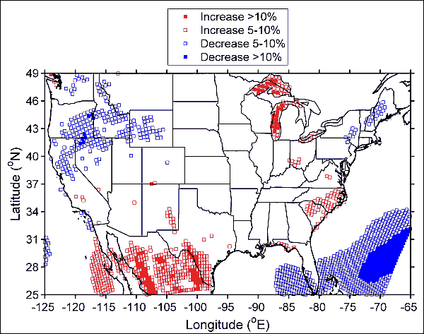

Results from the Canadian regional climate model (CRCM) show the difference in energy density (power in the wind) between 2041-2062 and 1979-2000
Results from the Canadian regional climate model (CRCM) show the difference in energy density (power in the wind) between 2041-2062 and 1979-2000. If the grid cell is red the future energy density is higher than the historical values and if it is blue the future energy density is lower than the historical values. Solid squares show differences above 10% while the open symbols show changes of plus or minus 5-10%. The white grid cells show that the future lies within 5% of the historical values.

Comparing model predictions for 2041-2062 to past observations of wind density (1979-2000), most areas were predicted to see little or no change. The areas expected to see continuing high wind density -- and therefore greater opportunities for wind energy production -- are atop the Great Lakes, eastern New Mexico, southwestern Ohio, southern Texas, and large swaths of several Mexican states, including Nuevo Leon, Tamaulipas, Chihuahua, and Durango.
"There was quite a bit of variability in predicted wind densities, but interestingly, that variability was very similar to the variability we observe in current wind patterns," Pryor said.
The Great Lakes -- Lakes Michigan, Superior, and Erie in particular -- consistently showed high wind density no matter what model was used.

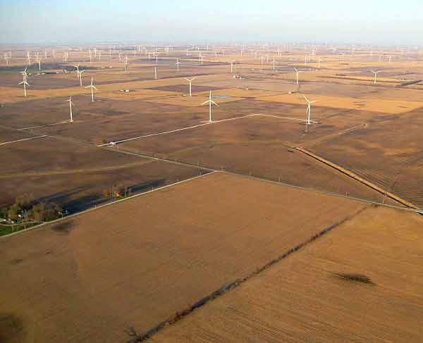

A large wind farm in northern Indiana.
