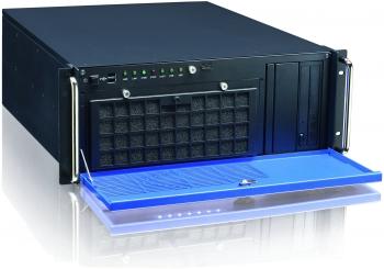

Kontron introduced the new Kontron Industrial Silent Server KISS 4U EATX. It hosts the extremely high processor performance and energy efficiency of two new 8-core Intel Xeon E5-2600 processors each with up to 2.5 GHz turbo clock frequency, and is housed in a robust, yet ultra-quiet, industrial server design.
Kontron - KISS 4U EATX
Thanks to the integrated motherboard for the Extended ATX (EATX) standard, the new Kontron KISS 4U EATX boasts an extremely high power density and scalability - paired with flexible configurability for individual application requirements. With a total of 16 processor cores, 36 threads and up to 512 GB of DDR3 ECC RAM the industry server with its long-term availability of up to five years is the optimal solution for performance-hungry applications such as industrial imaging, medical technology, cloud computing, as well as storage and simulation applications.
Kontron's Industrial Silent Server KISS 4U EATX with its low noise level of around 35dBA is also ideally suited for applications in noise-sensitive areas like manned control rooms and video surveillance systems. The KISS 4U EATX also stands out from other conventional servers, as it meets tough application demands, including high shock and vibration resistance as well as hot-swappable chassis fans which can now be exchanged more conveniently via the front panel, minimizing maintenance effort. Besides the standard version with IP20 protection, there is also a variant with IP52, which protects against dust and dripping water. The operating temperature ranges from 0 to 50 °C.

The feature set of the Kontron KISS 4U EATX in detail
  • 2x Intel® Xeon® E5-2600 processors E5-2620 or E5-2658 (socket R), C602/C606 chip set
  • 16x DIMM socket for up to 512 GB of DDR3 1600MHz RAM with ECC support
  • 3x PCI-E 3.0 x16 and 3x PCI-E 3.0 x8 for customer-specific extensions
  • 8x SAS/SATA 3Gb/s ports (RAID 0,1,10)
  • 2x SATA 6Gb/s + 4x SATA 3Gb/s ports (RAID 0,1,5,10) for connecting data storage devices
  • 2x 5.25" slots, 1x 3.5" slot (internal)
  • Options: DVD R/W, KISS Stor, KISS DA135, KISS DA335, KISS DA425, 2.5" SSD
  • 2x RJ45 Gigabit Ethernet LAN ports
  • 1x RJ45 IPMI-LAN port
  • 11x USB 2.0 (2x front, 4x rear, 4x via header, 1x Type A)
  • 1x VGA
  • PS/2 interface
  • 2x Fast UART 16550 ports (1x rear, 1x front)
  • 4U x 19" x 472 mm (H x W x D)
Thanks to a MTBF of 50,000 hours, Kontron's latest industrial server guarantees high availability while minimizing maintenance costs. The Kontron Industrial Silent Server KISS 4U EATX is CE certified and UL qualified. It supports Linux and Windows operating systems. Alternatively it can be configured to fit customer requirements and shipped as a complete, independently certified solution. The Kontron KISS 4U EATX is available in APAC and EMEA now.
