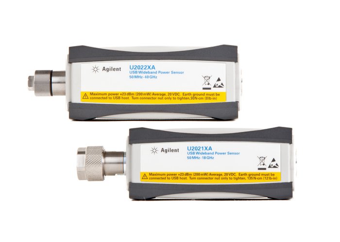

The U2020 X-series USB peak and average power sensors are now available worldwide. The U2021XA (50 MHz to 18 GHz) and U2022XA (50 MHz to 40 GHz) are priced at $6,700 and $7,100, respectively.
