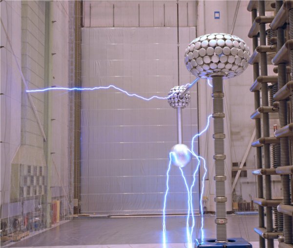

ABB has successfully developed and tested an 1,100 kilovolt (kV) ultrahigh-voltage direct current (UHVDC) converter transformer breaking the record for the highest DC voltage levels ever, and facilitating more power to be transmitted efficiently over longer distances.

Higher voltage levels allow larger amounts of electricity to be transported across very long distances with minimal losses using HVDC technology. Converter transformers play a critical role in HVDC transmission serving as the vital interface between the DC link and the AC network. Development of the 1,100 kV transformer addressed several technology challenges such as the sheer size and scale, electrical insulation and thermal performance parameters.
