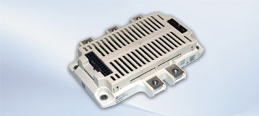

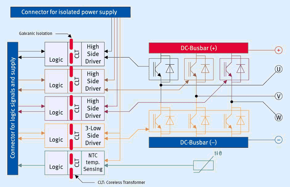

MIPAQ™ serve is an IGBT module designed by Infineon in a sixpack configuration with integrated driver electronics and digital temperature measurement. The integrated driver provides several protection features as well as galvanic isolation using Infineon's Coreless Transformer Technology.
Infineon - MIPAQ serve
By eliminating optical couplers, this technology further enhances the module's long-term stability.
MIPAQ™ serve comes with the EconoPACK™ 4 package and the latest IGBT4 chip technology. It covers the 1200V range and manages currents of 100A, 150A and 200A. The supply voltages and logic signals are transferred through standardized connectors while the power connections are established with M5-sized screws.
All integrated features are fully tested and reliable operation is ensured. These functionalities make MIPAQ™ serve a full plug-and-play solution for various applications with higher powers. No time needs to be spent designing and testing the driver circuit - this significantly accelerates your time-to-market!
MIPAQ™ serve functional diagram
MIPAQ serve functional diagram
