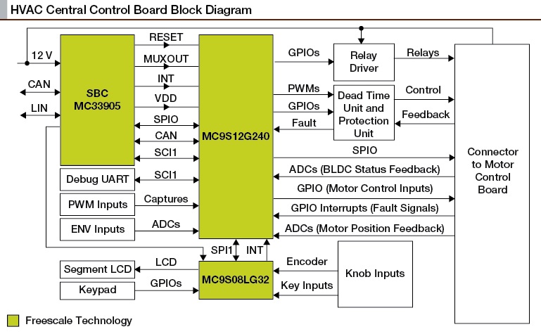

RDS12GHVAC Block Diagram

Freescale Reference Solutions for Automotive HVAC Control RDS12GHVAC

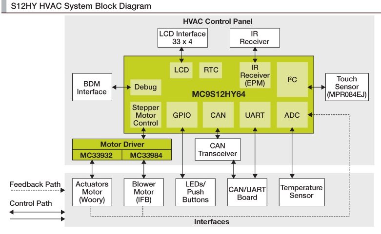

RDS12HYHVAC Block Diagram

Freescale Reference Solutions for Automotive HVAC Control RDS12HYHVAC
