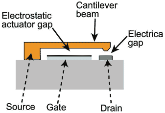

The European Commission likes the idea and has put IBM Research Zurich in charge of a European research project that aims to produce a logic process that is based on nanometer-scale relays that remain compatible with conventional CMOS transistor logic. The advantage of such a system would be much lower off-state power consumption as leakage current would be considerably reduced.
Mechanical relay as replacement for transistor. Source: NEMIAC

The NEMIAC (Nano-Electro-Mechanical Integration And Computation) project aims to develop a process based on what it calls nano-electromechanical (NEMS) switches suitable for embedded systems and offering 3-D integration with CMOS. The researchers are being asked to show a magnitude improvement in energy efficiency with no performance penalty compared with solid-state. The process is also expected to have higher radiation resistance and higher temperature operation than CMOS.
The relays are expected to have a footprint of less than 3-micron by 3-micron and demonstrate a switching time of the order of 10 nanoseconds. Prooving the reliability under billions of switching operations will be an important task prior to commercial deployment.
