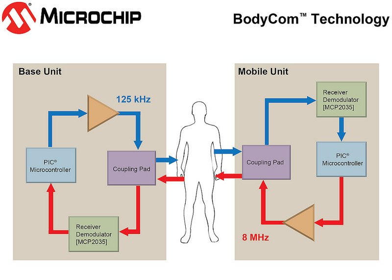

BodyCom technology is activated by capacitively coupling to the human body. The system then begins communicating bidirectionally between a centralized controller and one or more wireless units. There are a broad range of applications where secure wireless communication is essential, and there is no more secure channel than the human body. This is especially true when you add bidirectional authentication that supports advanced encryption, such as KeeLoq technology and AES. For example, BodyCom technology helps prevent the “Relay Attack” problem that is typical in automotive passive-keyless-entry security systems.
Microchip’s BodyCom Technology
Click to enlarge
Most secure, short-range communication designs are battery powered and highly cost constrained. BodyCom technology significantly increases battery life by eliminating the need for a wireless transceiver or high-power inductive fields. It also simplifies development and lowers BOM costs by not only making antenna design unnecessary, but also by using a low-frequency framework with a common microcontroller and standard AFE frequencies (125 kHz and 8 MHz)—no external crystals are needed. And, because it complies with FCC Part 15-B for radiated emissions, BodyCom technology eliminates the cost and complexity of certification.
