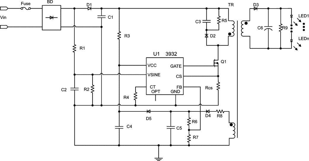

 IS31LT3932 - Typical isolated Operating Circuit
