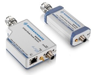

Rohde & Schwarz presents its new R&S NRPxxS and R&S NRPxxSN USB three-path diode power sensors. The completely redesigned sensors offer unprecedented measurement speed and measurement accuracy, even at low levels. The R&S NRPxxSN model offers both a USB and a LAN interface. Both power sensor models are available for three different frequency ranges, from 10 MHz to 8 GHz, to 18 GHz and to 33 GHz – the largest choice of ranges on the market.
Rohde & Schwarz NRPxxS
Outstanding measurement speed
The R&S NRPxxS/SN sensors enable 10 000 triggered measurements per second with a minimum trigger resolution of 100 µs. A special mode even permits in excess of 50 000 equidistant measurements per second. And the improved three-path diode design made it possible to decrease the lower measurement limit to –70 dBm. The result is a very wide dynamic range of 93 dB and instruments that can measure up to four times faster than previous solutions, especially at low levels.
LAN operation via web browser
The new LAN interface on the R&S NRPxxSN model now allows remote power measurements over large distances. For example, it is possible to control monitoring applications for satellite systems or particle accelerators via a central PC by placing sensors at various positions in the system. The power sensor is conveniently controlled from a GUI accessed via web browser. No additional software is needed.
Numerous test modes for a wide variety of applications
Thanks to their outstanding performance, R&S NRPxxS/SN power sensors help mobile communications users perform power measurements on signals such as GSM, 3GPP, LTE and LTE-Advanced. The 33 GHz model is also ideal for development and production of anticollision radar systems in the automotive sector. The continuous average, burst average, timeslot average, gate average and trace measurement test modes all remain available.
